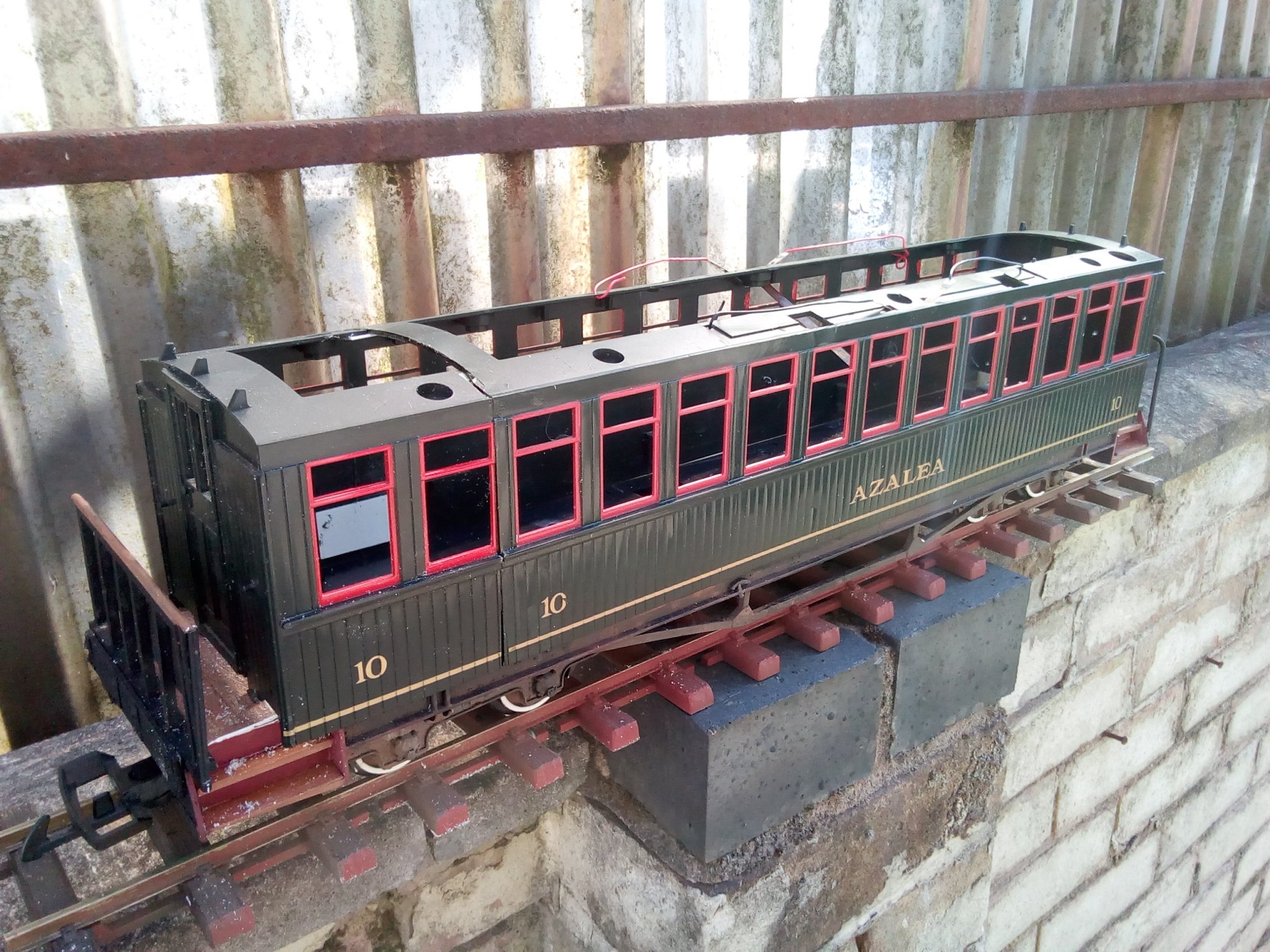

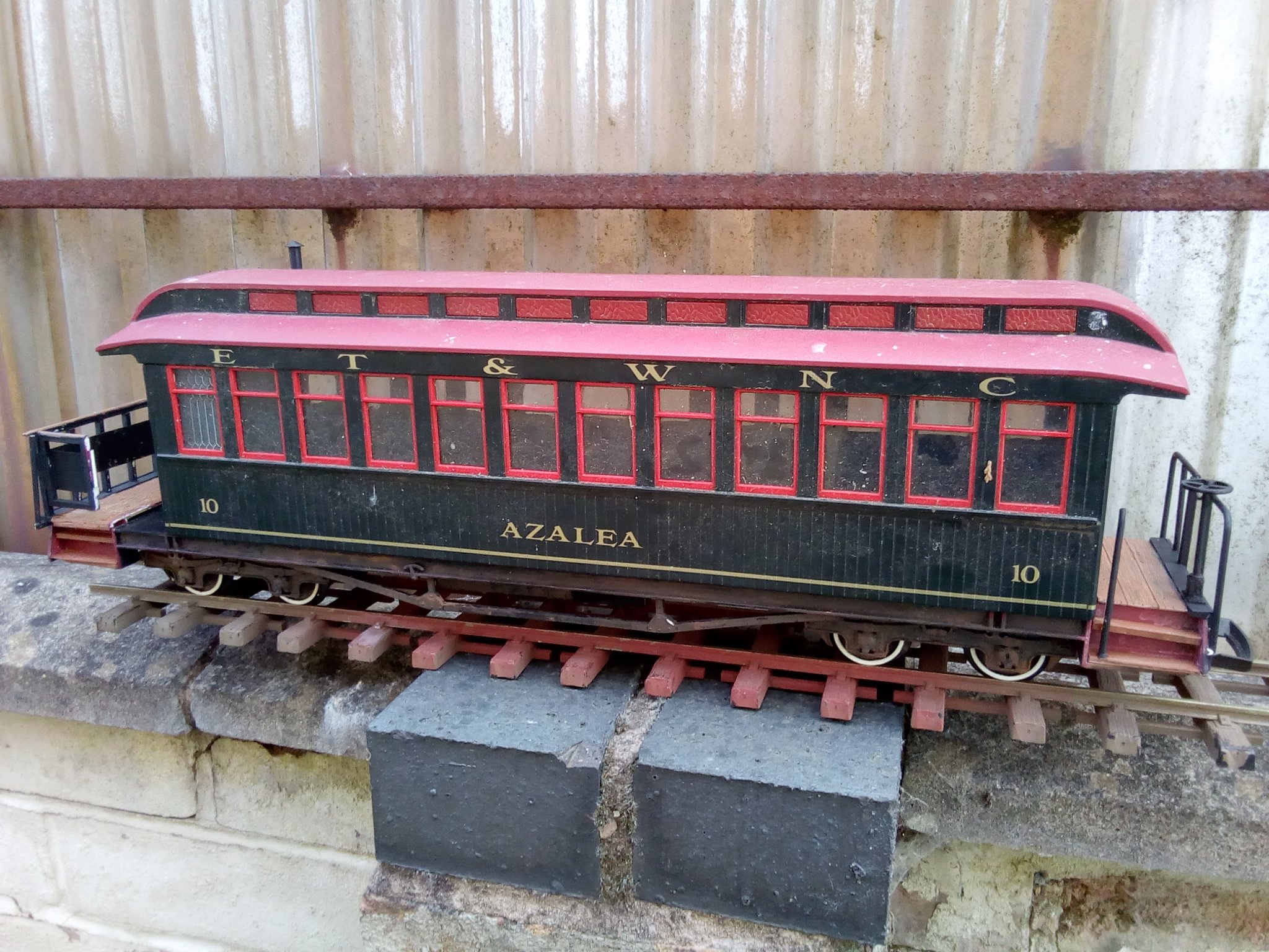

About 5 years or so ago I started a project on a private car build from a cheapy Chinese car,lots of work done on the thing such as it was cut down to window level and a new boarded body built over it as it was flat sided and so on but the roof didn"t work very well and when a Bachmann item came along on a visit to Glendale the project was scrapped,it never ran only to test and has laid forlorn in the box in the garage since then.
No 3 son came to me a few weeks ago and asked if, "I could use these",3 Bachmann JS bodies with all the interiors intact and a box car body,needless to say I took them off him with pleasure,the box car body has replaced an old worn out item,one of the roof sections will go on an old combine to bring that back into service but what to do with the other bodies?
So after giving it some thought I asked myself if I could mount the Bachmann body on the Chinese frame,testing it all this morning it seems it just might work although the body and frames are different lengths ,two bodies spliced together would give me a result,the main thing I noticed is that the body will ride higher on the frame but this if not too noticeable may look OK behind Connie for instance.
Over all I think I may just give it a go,nothing ventured nothing gained and a very cheap bash if it doesn`t work,my bash from a boxcar to a long caboose worked fine so why not this,,a little more thought needed before starting but I have decided to try at least
