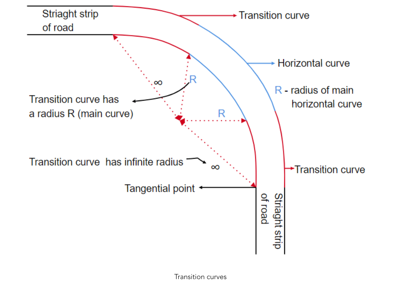

I think when you need to go for "tight" curves, i think you want to make use of transaction curves.
Even on my 5-meter radii curves in the running line i use them.

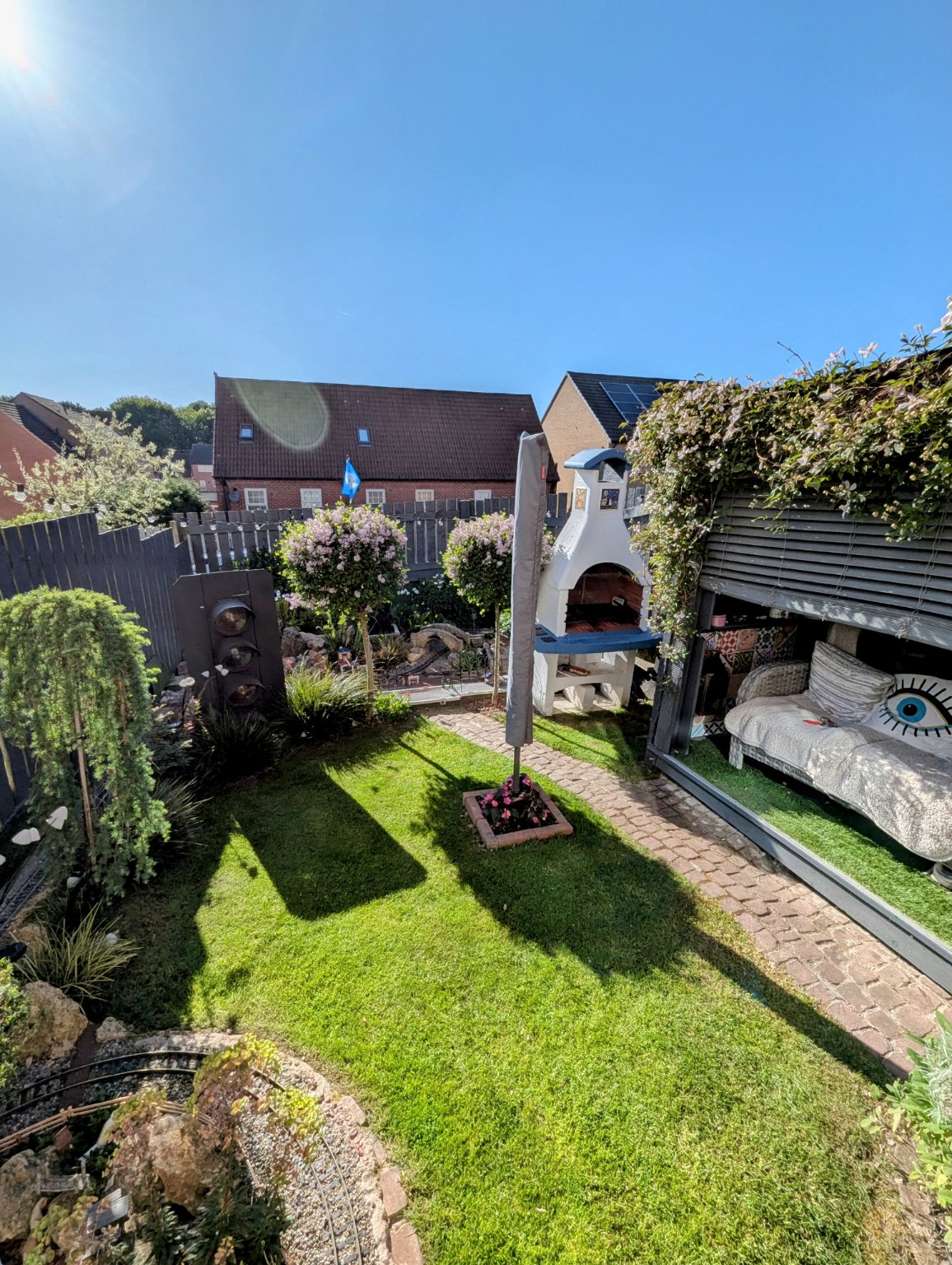

I have many R1 corners, and most of my points are R1. I have however eased some corners as the railway has developed. My main reason for R1, is that my garden isn't massive. The R1 makes the best use of my layout, and allows me to still have a garden. Rather than a railway with a bit of garden, I have a garden with a railway amongst it.
