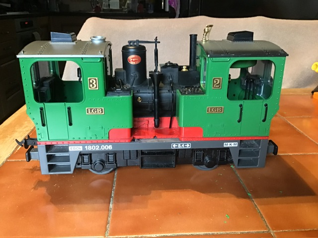

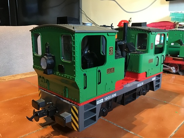

A couple of years ago I started modifying my Plamobil tractor loco. I am or was installing miniature gear motors and R/C equipment in order to have the boom and shovel move by remote control. Also the outriggers will move outward and inward by R/C. It's been sitting in a box awaiting my return of enthusiasm.
Unlike your project, I had to butcher the original loco.....So no going back.....Only forward, let someone else have at it, or at worse, into the dust bin.....:rolleyes:

If that moment comes to be that my enthusiasm simply gives up, I will announce it so that any one of our members can have at it.....:)

I agree with PhilP - cats out of the bag and you've announced your return to the project on the perfect thread. Looking forward to seeing some updates!

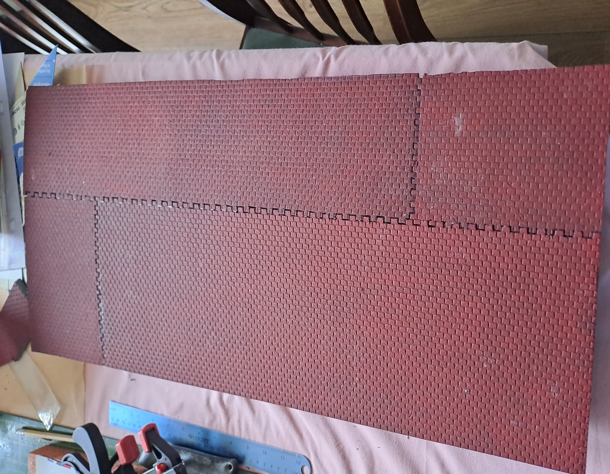

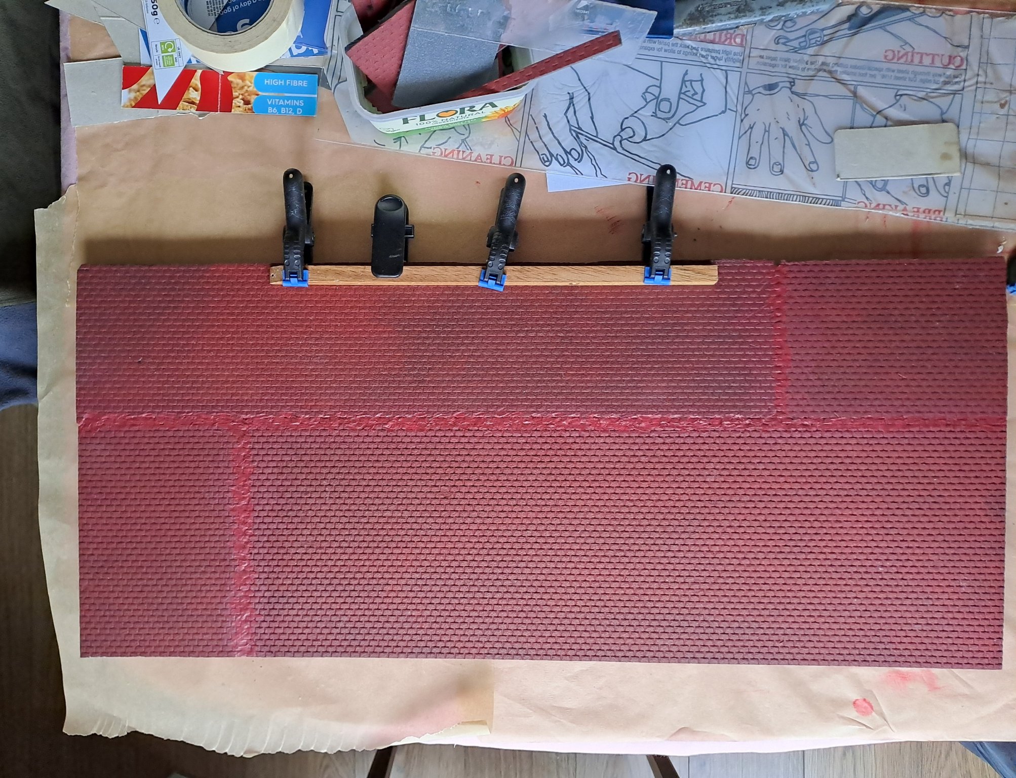

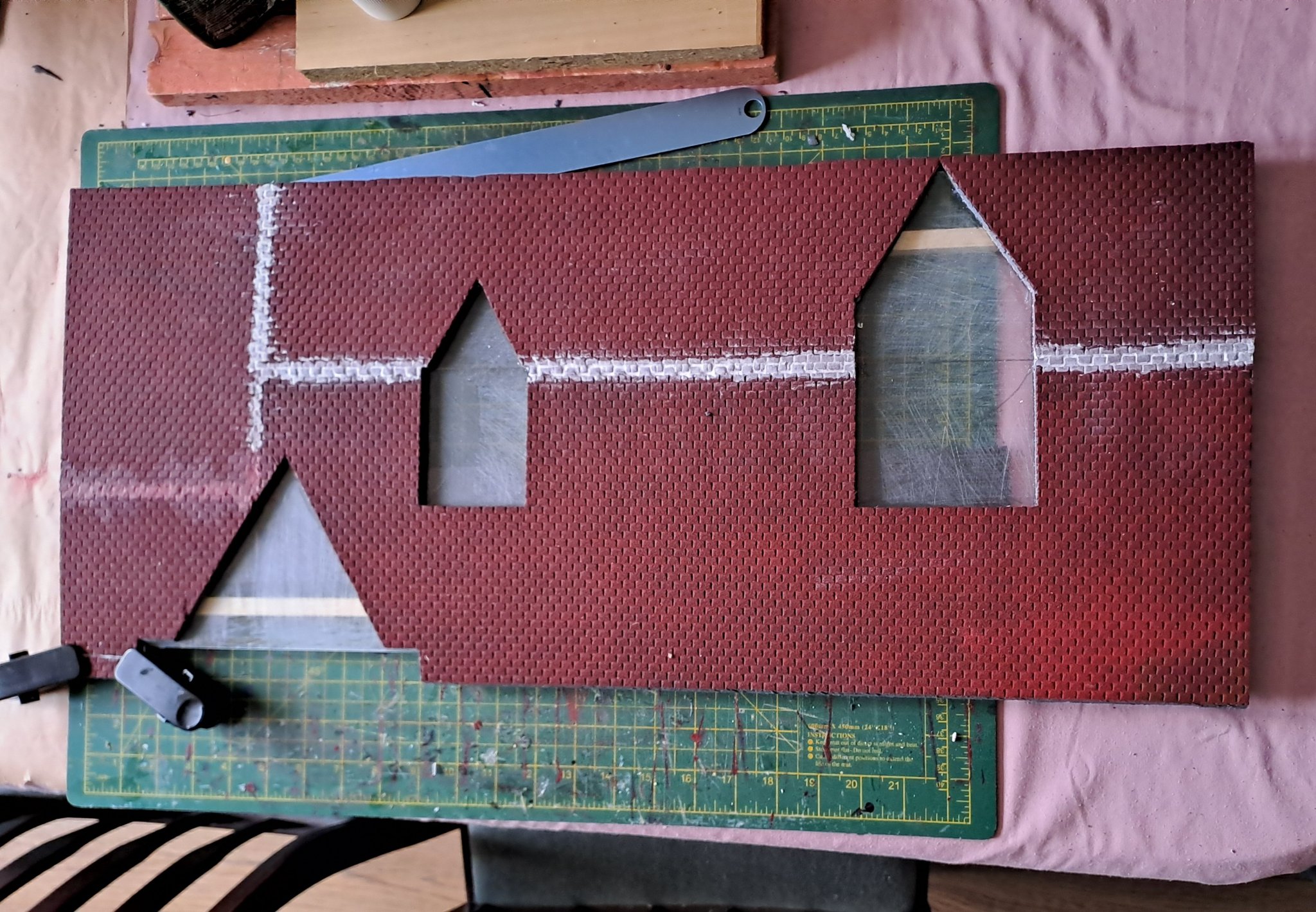

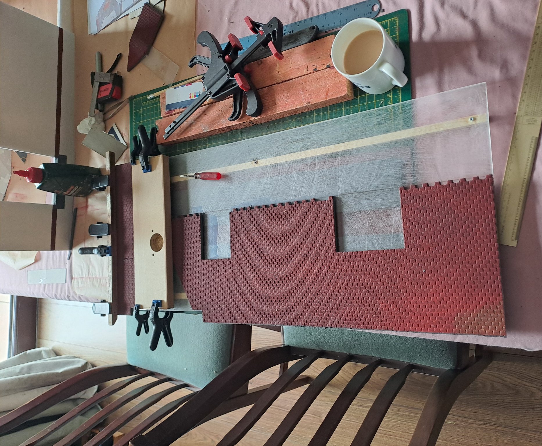

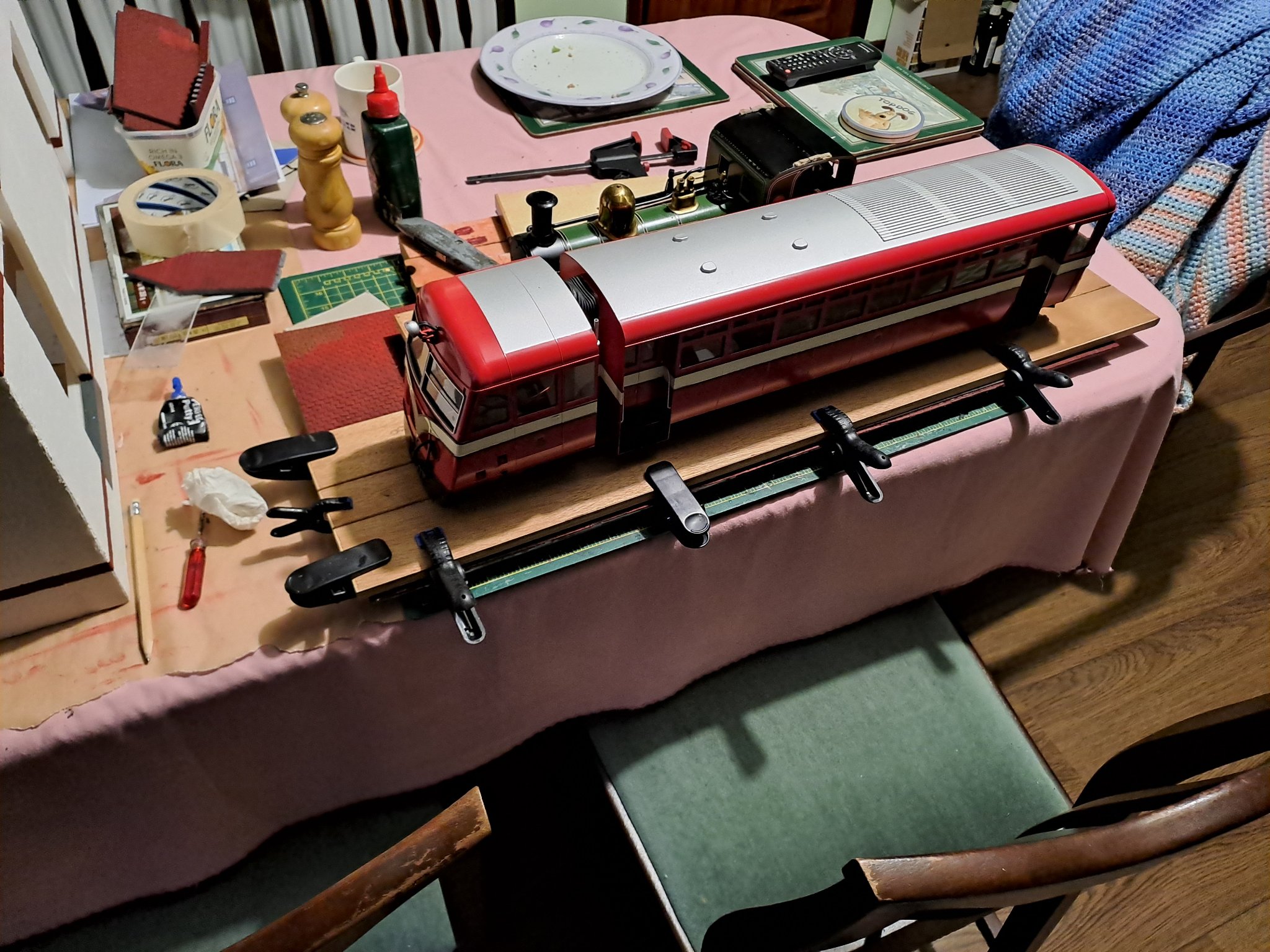

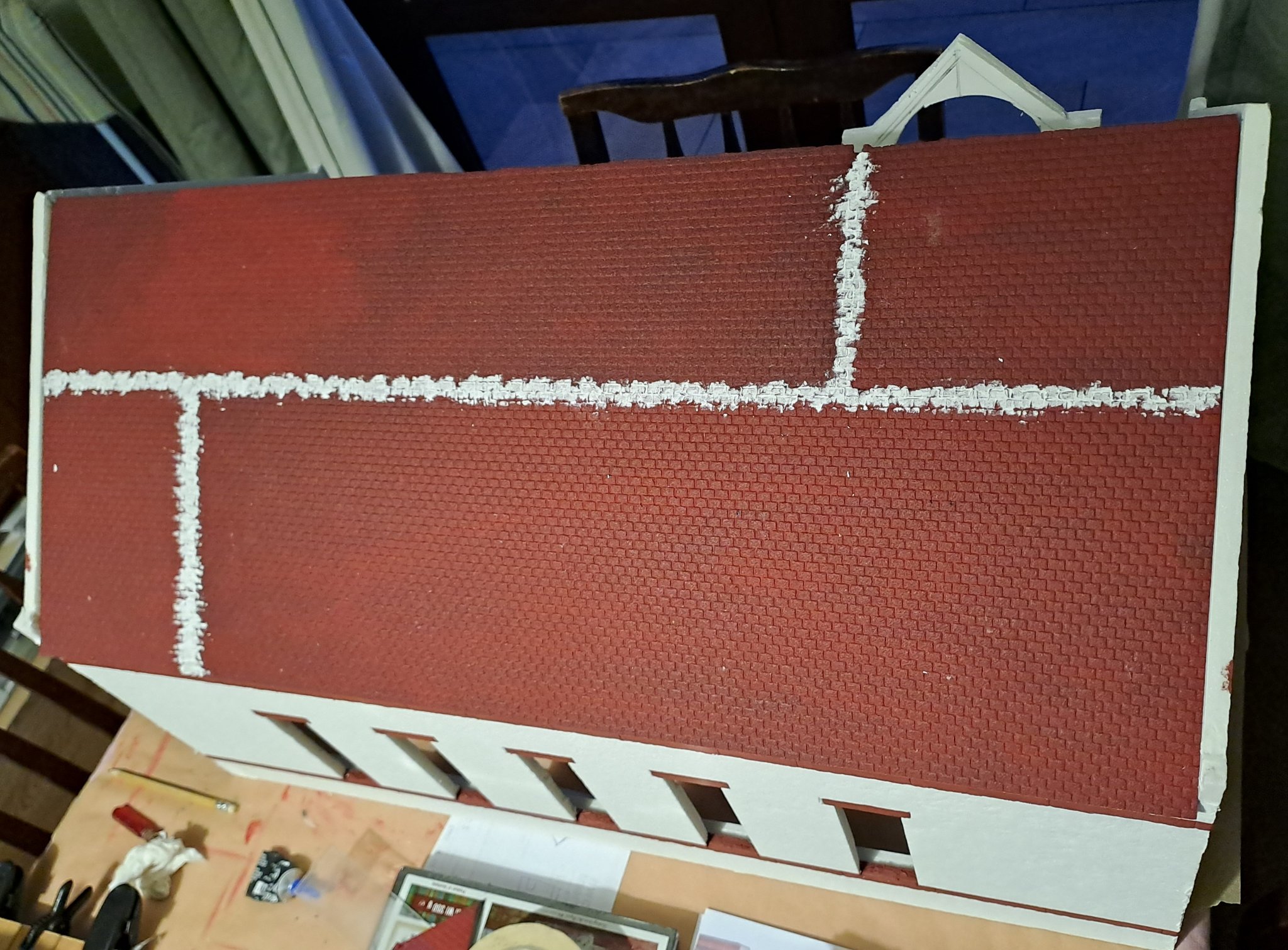

I glued down the goods shed foamboard roof panels to the acrylic sheet over the weekend, filling the joints and putting on some paint, next will be constructing the dormers, but first, I might have to add some supporting spars as since the glue has dried, a slight bow20260208_140534.jpg
20260208_173305.jpg20260208_173348.jpg20260209_152912.jpg20260208_140338.jpg20260209_152802.jpg
I glued down the goods shed foamboard roof panels to the acrylic sheet over the weekend, filling the joints and putting on some paint, next will be constructing the dormers, but first, I might have to add some supporting spars as since the glue has dried, a slight bowView attachment 352953
View attachment 352954View attachment 352955View attachment 352958View attachment 352956View attachment 352957
I have exactly the same workshop weights! :rofl:
You need to be careful having the PVA next to the salt and pepper: we all got told off by an H&S inspector for having PVA in an unlabelled Fairy Liquid bottle, in the days when they weren't transparent. All the pupils knew what was in them, but oh no, our man knew better: 'What would happen if a pupil used it to wash their hands?'. Well, they'd get water-based, completely inert PVA on their hands, which would wash off...

Fezwig Fezwig , ideally you need a 'balancing veneer' on the underneath of the roof: the glue contracts as it cures, 'pulling' the glued side to make in concave. It's why plywood always has an odd number of layers. You don't fancy modeling the backs of the tiles, do you?

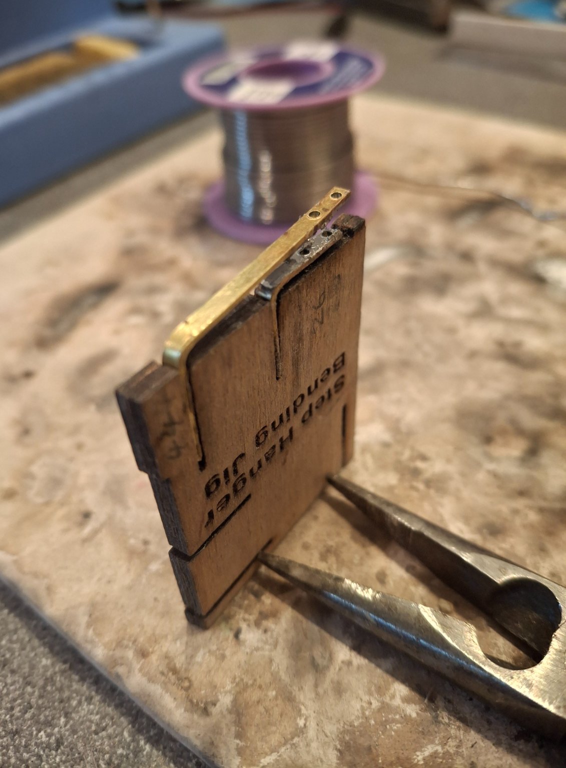

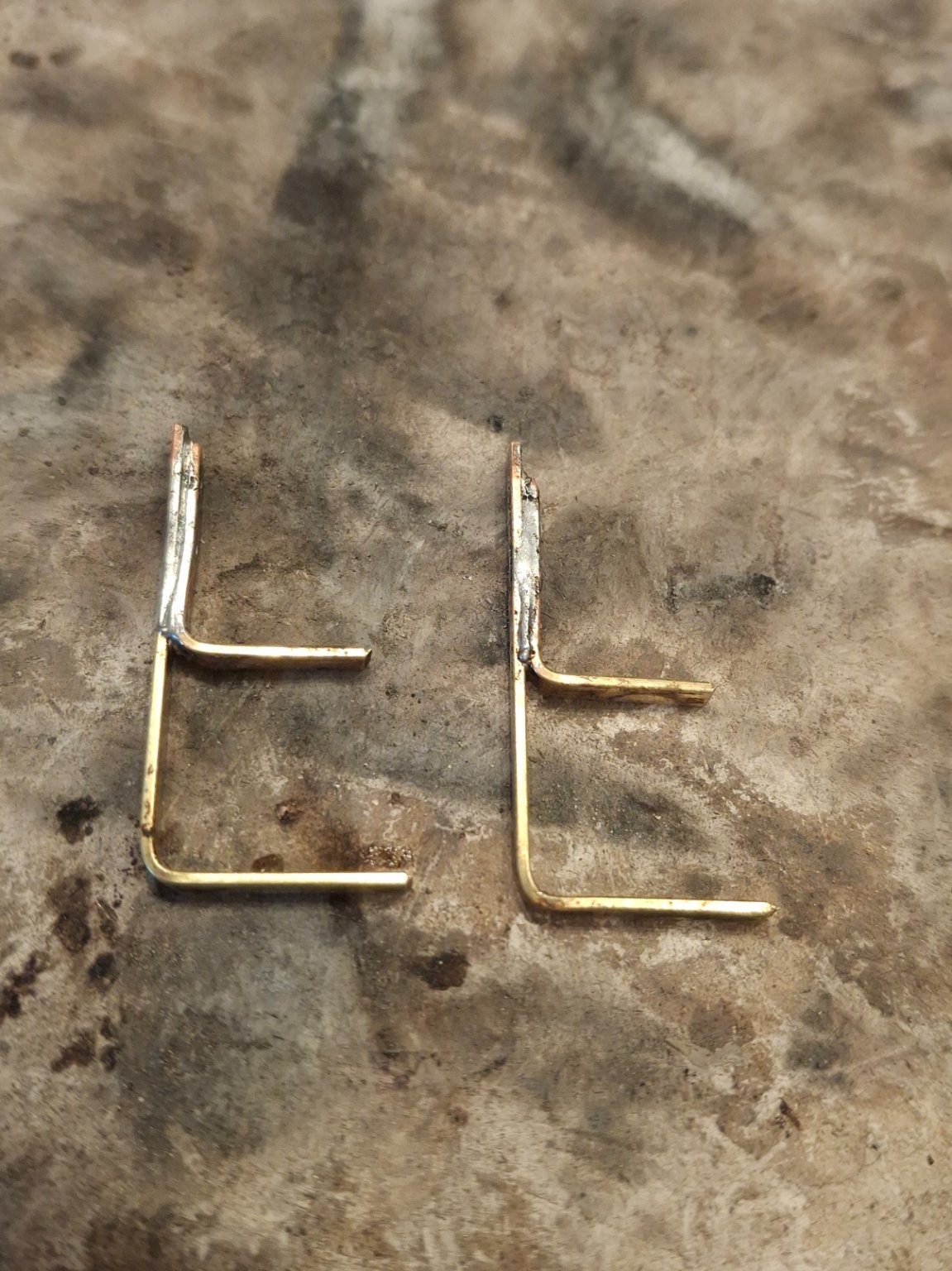

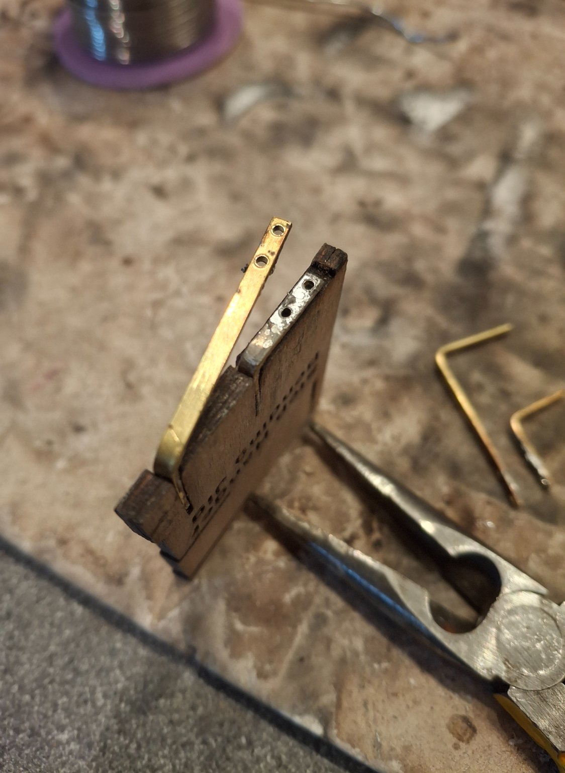

The saloon build stalled a few years ago because the step hangers went together all wonky and I walked away in frustration. Having built the carriage roof, I couldn't put them off any longer, so applied heat to softern the epoxy holding the steps on, and more heat to (de-solder? unsolder?) the brackets. I then had a brainwave: why not use the accurate, laser cut bending jig to hold the parts whilst soldering them? That way, they would all be notionally identical...
But first, some of the parts needed tweaking to get them aligned
before they could be soldered back together
Bingo!

I made the jig when I still had access to the school's laser cutter. It wouldn't be difficult to make one by hand (a jig, that is!) using an offcut of ply and an X-Acto saw, but it was nice to have the technical option!
