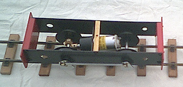

The chassis looks like an Essel Engineering product. They have a good reputation.

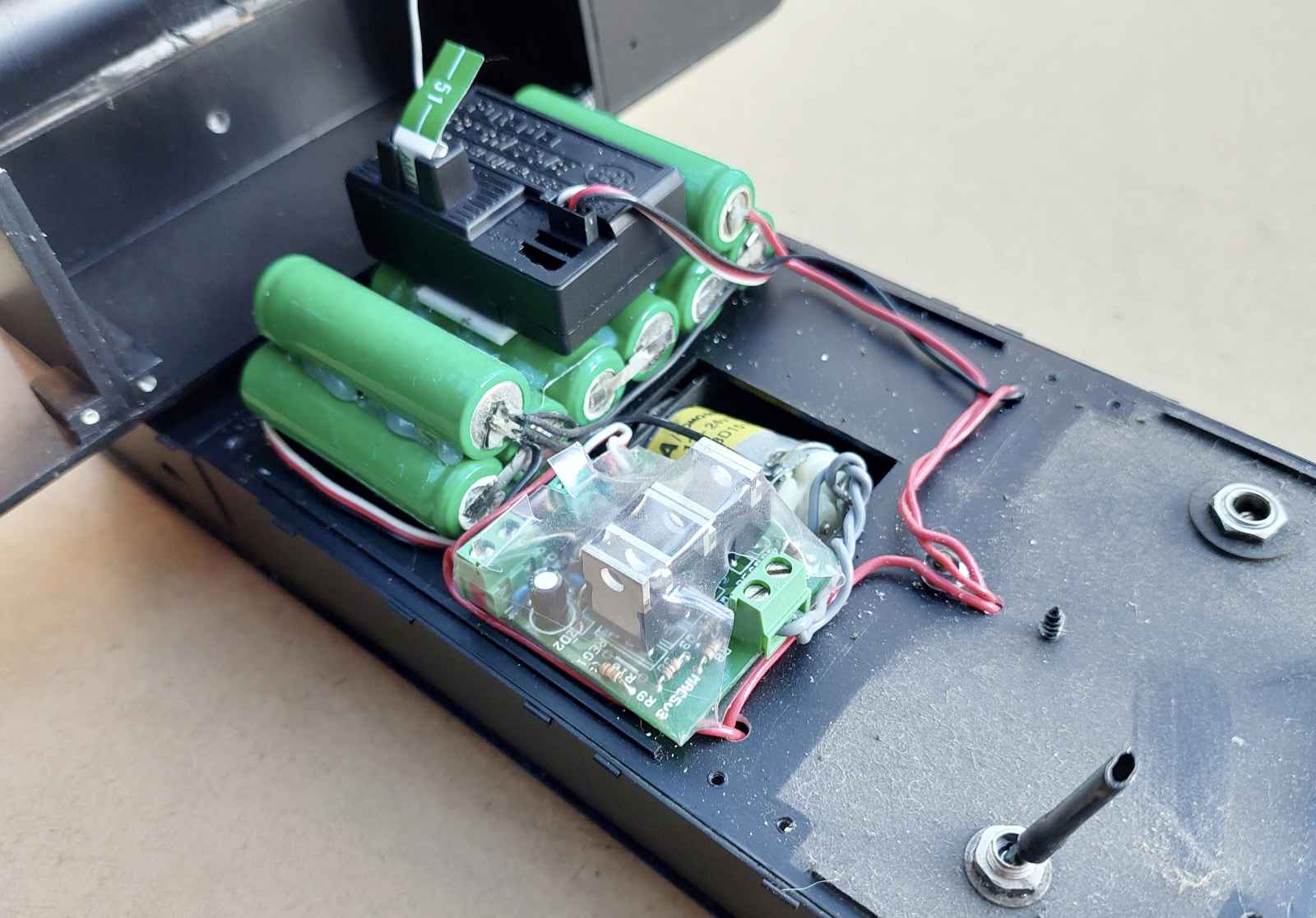

Your photo of the underside shows the wires from the charging socket going in to the side tank - an obvious place to hide the batteries.
I wouldn't try charging until you know what kind of batteries.
I suspect that the 4 Philips screws visible underneath in the corners will separate body from chassis. Nothing ventured, nothing gained!

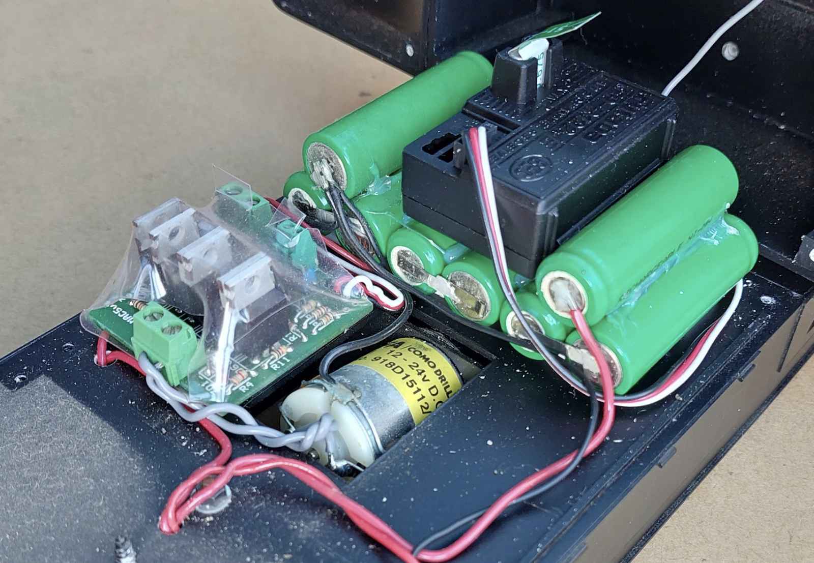

It took a while to find the time to do more investigation. There were six tiny screws needed to be removed from underneath to expose the innards. What I do know is the battery pack has eight cells but beyond that it's out of my knowledge. It's battery powered but is it radio controlled? There is a single white wire that goes up into the cab and disappears behind the driver who is glued in place, could that be an aerial?

That looks suspiciously like a Mac 5 from Brian Jones. It's an Electronic Speed Controller (ESC). 8 cell, 1.2v per cell, NiMH rechargeable pack. On top appears to be a Futuba receiver (RX). Yes, wire is the aeriel. You need the correct Futuba transmitter (TX) to link to it and control. See search link below for transmitter. You could change out the reciever to any other compatible with the Mac 5 if you need/want to use a different TX. Brian Jones very much still in business if you need advise, he was very helpfull when I boughf my MAC5. I have an earlier verision in my first RC/battery/sound conversion, a 16 mm scale GRS L&B Manning Wardell. I did it about 15 years ago. Nice bit of kit. I have mine bound to my Spektrum DX6i TX.

Many thanks for all that information. Unfortunately I have a feeling that this lovely model is not for me. I run track powered LGB and Playmobil plus a little of the basic RC Playmobil so this would need a new type of set up. Looking closer it is a Mac 5v3 and the RX is a Futaba FP-R122JE.

An ancient receiver. - It has a crystal plugged in for frequency / channel selection, and a Mac5 speed controller..
9.6V of NiMH (very probably) batteries.
