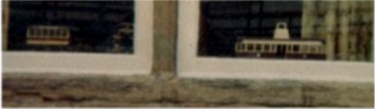

I started modelling trams 55 years ago. My first was based on a Triang Big Big Train chassis - model of one of the 1891 Stephenson cars that ran in Leeds - very similar to the J & S car modelled by Bachmann. The only real difference (apart from the trucks) between the two American manufacturers were the clerestory windows - Stepenson's had more smaller windows.
A very poor image taken in 1971 when we lived on the farm. The other car was the last all-new tram (a VAMBAC - British version of the PCC car) .....
