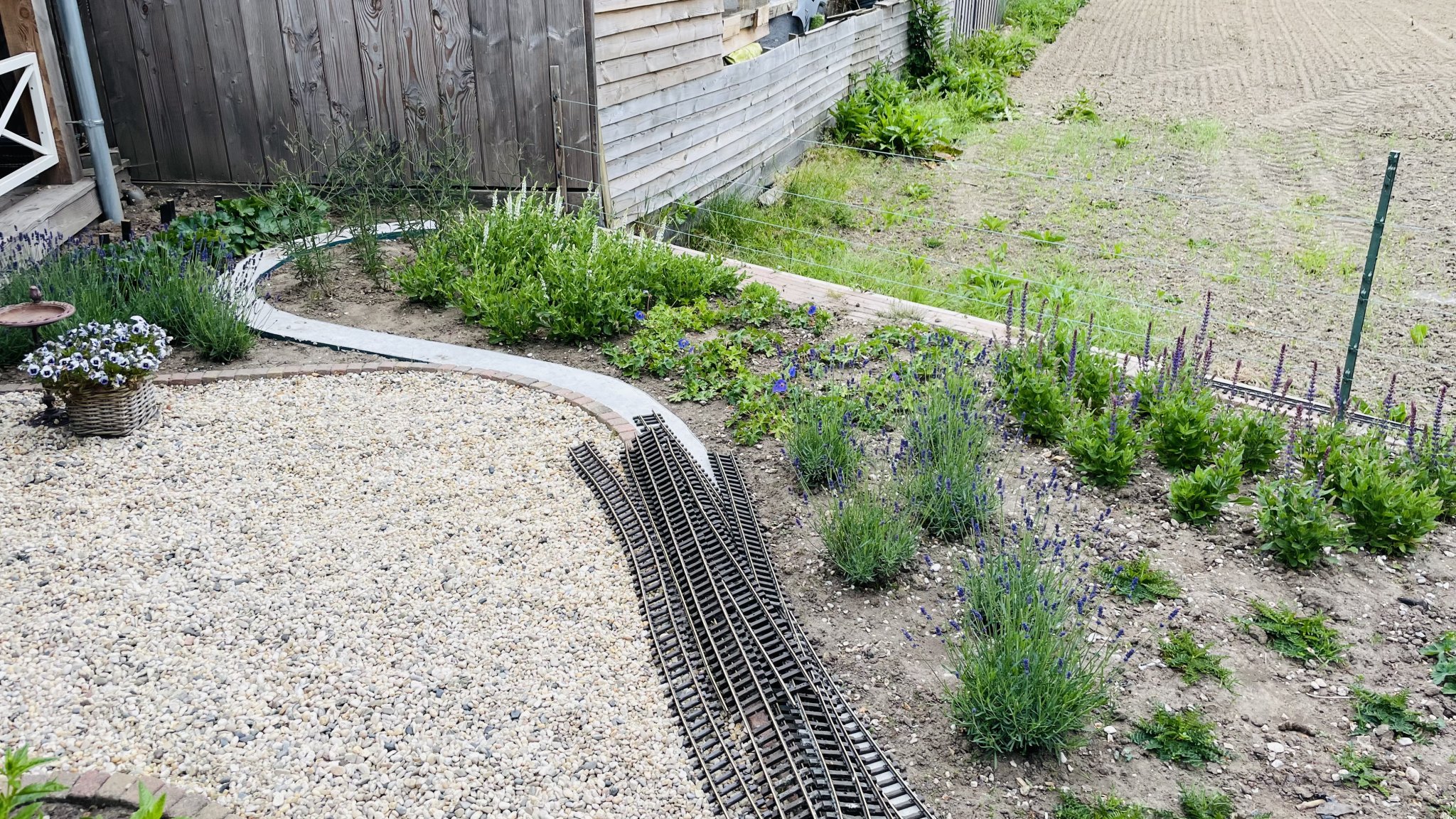

Yes, my favourite track. It is also made by LGB but the sleepers are not connected by two strips of plastic, but just one. This makes it possible to bend the track in any curve you like.
Here you can see my latest purchase, about 15 meters of flex track. Clearly visible is the curves you can make in any radius you want. These are very mild curves but you can of course bend it to R1 if required.

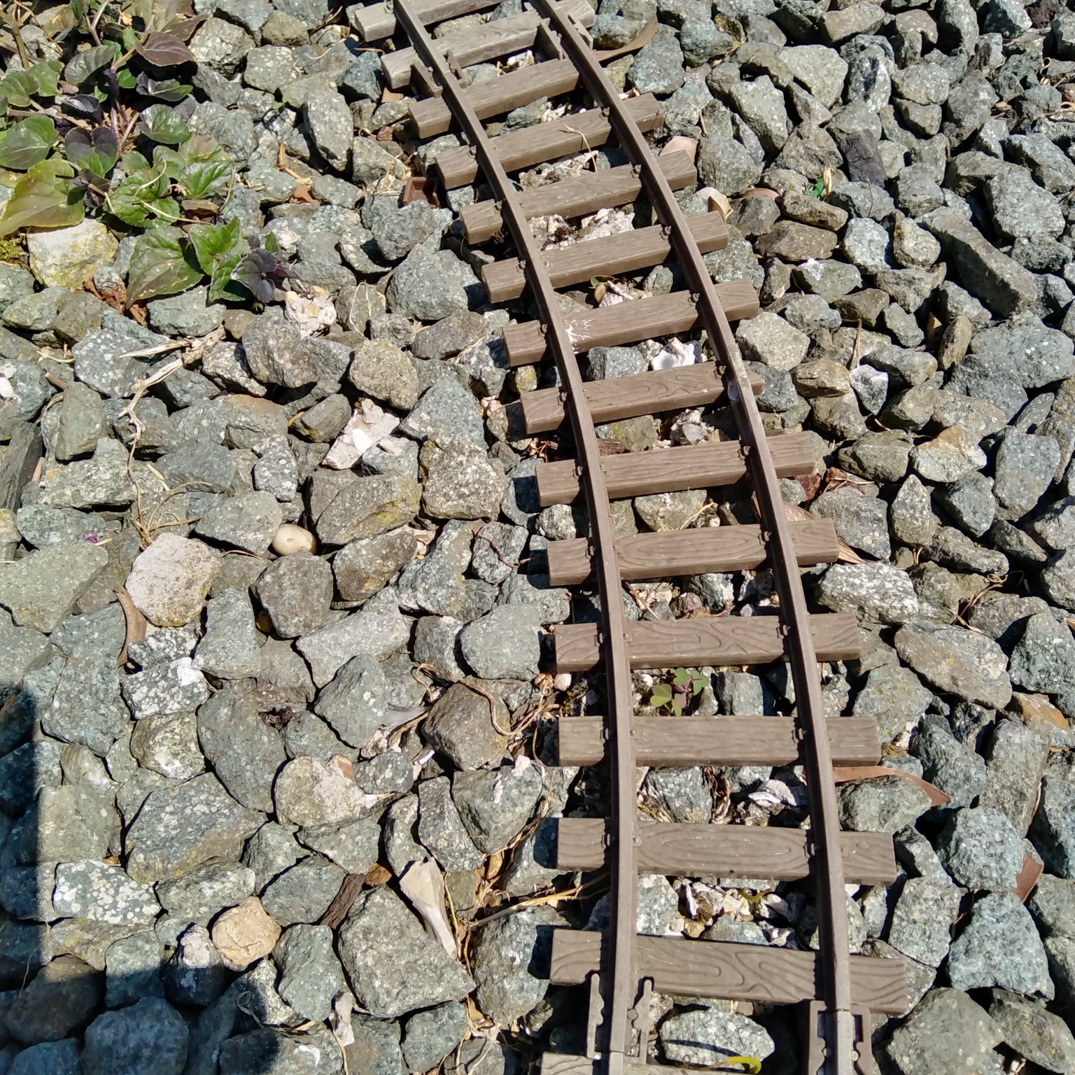

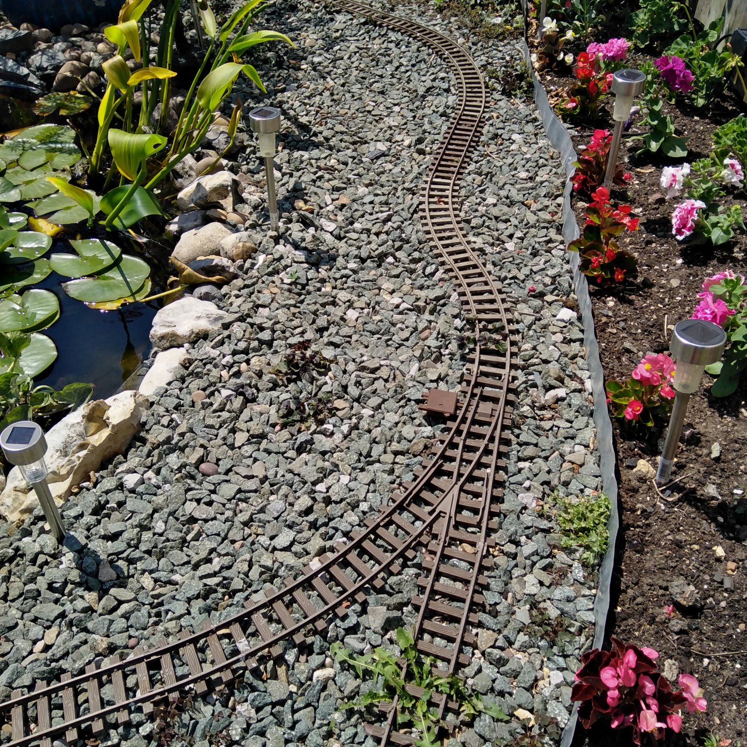

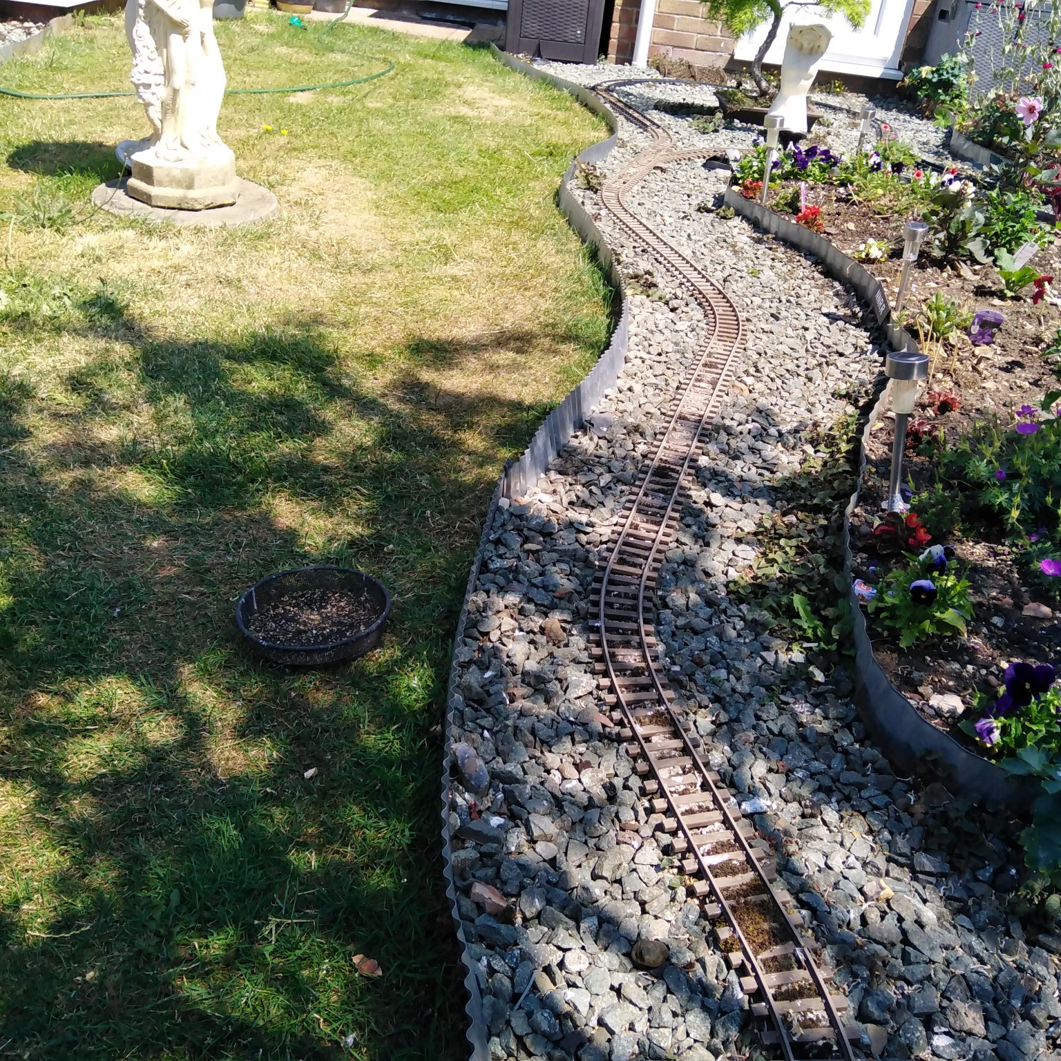

my cheep plastic track
