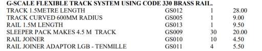

Reading through a lot of forum posts I came across a reference to Tenmille track and found this on their website:
I can see they supply adaptors for LGB but is the end result any good or should I stick with LGB and Aristocraft?

I would suggest for ease of supply, cost and availability (especially second-hand) stick with LGB, Aristocraft, and Piko (that is not Peco). Trainline45 is another make you may come across.
As you can see form the Tenmille advert, the rail is not quite the same, so you really need the adaptors to join the two makes together. - an extra 'faff' when you are starting out.

Many years ago I built my first oval of track for my son, well that was my excuse ! It was about 12 ft long and was all LGB track. When it came to extending the line to go all around the garden the cost saving of Tenmille track was significant compared to LGB. As it was a single track line gently winding around the garden, flexible track was also an attraction.
So, many metres of Tenmille track were purchased and I had a simple line meandering around the garden. The Tenmille track being a thinner section, is easier to bend and made a pleasing appearance winding through the plants and shrubs. The end result was good and the connection to LGB was not a problem.
The connection to the LGB track required a single adaptor on one rail at each connection to the LGB track. The LGB fish-plate is squeezed enough to hold the thinner Tenmille rail. That was simple enough.
A year or so later I decided to add a station with a passing loop and siding. That required 3 points and all had to use 9 adaptors to fit the Tenmille rail. I am not sure if this was the time to move away from Tenmille or if it was at the next addition of points etc. But slowly the Tenmille was being replaced with LGB compatible rail. Even when I didn't need to replace the Tenmille track I have replaced it.

When I laid out my garden line some 20 years ago, I used Tenmille G-Scale ** track and points. As a sizeable order (100 yards plus 6 points), I went to the factory to pick it up. Most of my line continues to be Tenmille.
As I made alterations (new junction, addition of a passing loop, etc.), I tended to buy LGB track (available locally) and used the "crimped LGB joiner" method where the two different rail profiles met. The Tenmille track that was released all got reused in storage sidings. As those "crimped joiners" became unreliable I have replaced them with standard track clamps (Hillman, designed for LGB rail) letting in a short length of copper wire, stripped from mains cable, to give a tight fit on the narrower Tenmille rail. That has proved to be reliable.
The only shortcoming I have encountered with Tenmille equipment is that their points don't have the rigidity of LGB points. They are fine if laid on a perfectly flat surface but are likely to cause problems if the ground is uneven, or becomes uneven with the movement of the earth in different weather conditions (I'm on clay!).

Yes, Tenmille code 332 can be mixed with LGB and its clones (same rail height) - However, you will require their plastic track adaptors, with brass strip liners, to connect. So, there maybe longterm conductivity issues unless you bond the rail ends (solder jump leads) or clamp. If using track clamps you will require special "Hillman" type clamps that will only conect Tenmille to Tenmille code 332, difficult to find now - the rail cross sections and the Tenmillle's flatbottom is narrower than LGB's. There are no clamps that will connect Tenmille to LGB on a mix and match basis. Sleeper appearance is different from LGB. If you are using a track bender you will need different profile "roller wheels" to bend the rails.
Otherwise a good emergency product if no LGB type available or you layout has minimal needs to acheive any desired configurations. Max

If using track clamps you will require special "Hillman" type clamps that will only conect Tenmille to Tenmille code 332, difficult to find now - the rail cross sections and the Tenmillle's flathead base is narrower than LGB's. There are no clamps that will connect Tenmille to LGB on a mix and match basis.
I agree that Hillman's 332-01TM track clamps are "difficult to find" (maybe even impossible!). If anyone has any, I'd like to buy them (or swap for clamps that fit LGB rail).
But, as I wrote above, you can successfully clamp Tenmille rail to LGB rail (or even Tenmille rail to Tenmille rail) using standard Hillman-type clamps for LGB rail . . . by inserting a thickish copper wire against the foot of the Tenmille rail before you tighten it. This method has been reliable for me over (so far) a two-year period.

Be aware, as you are considering it, that while Piko and LGB code 332 track systems are perfectly compatible (as are Trainline's, Bachmann's, USAT's, Aristocraft's, Accucraft's and some others similar brass rail systems ) their radius numbering system is not, e.g. LGB R3 is a Piko R5. There are various anomalies in the different makes track geometries.
With regards to the idea of crimping an LGB fishplate to mate a Tenmille code 332 rails to it is risking almost certain electrical conductivity issues in the long term unless you bond the rails as ge-rik says. Problem is if you bond the rails and you are just starting out, with a layout that is bound to evolve, you are into a lot of work separating track sections, reorganising and rationalising your track stock and then rebonding it. Something to do when you have the finished article perhaps.
I bought 4.5 metres of Tenmille code 332 and their sleeper pack about 12 years ago. It is still down but I never bought any more because of the issues I have described. Most of my line is in full or semi shade and due to the damp UK climate and is prone to the brass tarnishing issues that can cause voltage drop outs, these have required remedial work with the application of track clamps and a good dose of graphite paste as a corrosion inhibitor at all the track joins. Max
