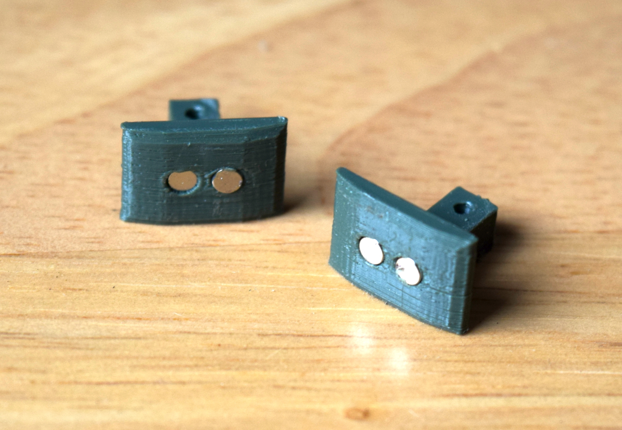

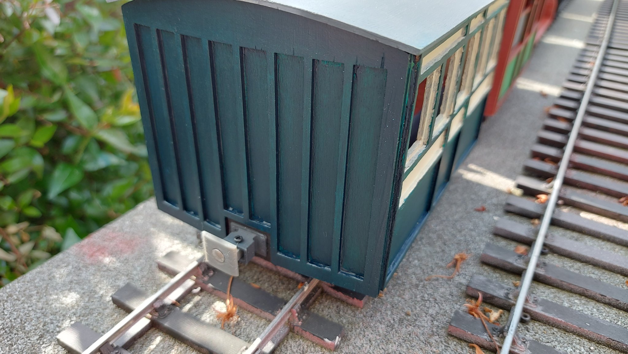

Sharing my simple magnetic couplers as used on my Ffestiniog stock. 16mm Narrow Gauge magnetic coupling by noiseboy72
Hopefully of use to someone. They just need a 6mm magnet and a small screw to complete.
Nice job but watch out for derailments on sharp curves because there is no flexibility in the horizontal plane. I have a 009 layout (for indoor amusement) and recently replaced all the couplings with Hunt magnetic couplings. The result was frequent derailments on sharp curves so I had to change them all back.

Thank you.
I designed the coupling to have quite a lot of both horizontal and vertical slop - much easier to attain in G scale, so the coupling can cope with 2' radius. The body is larger than the coupling shaft, and by using a couple of M2 sized self tapping screws as the pivot, about 30⁰ of movement are possible for each coupler.
Quick video of the stock on my garden railway, which has 2'6" curves in a couple of places.

I used 6mm x 2mm. They have a holding force of about 750 grams, which is not far off the tractive effort of even quite a large loco. Make sure the magnet faces sit slightly proud of the coupling, so that they fully connect. They do need quite a tug to disconnect!
You can always adjust the screws and screw holes to give more flexibility if required.

You are correct, these are handed couplers, so if your stock gets turned in service, it may not be suitable.
I do have a design tweaked by another user, which uses a pair of 3mm magnets mounted North to South, side by side. I'll upload the files to Thingiverse.com and share the link.

This is the dual magnet version.
