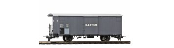

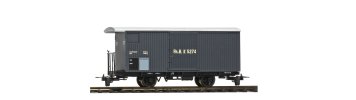

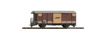

Grey was an early livery but the early vans differ in detail. Of course the modern version can run quite prototypically with Heidi in black or Rhätia in green.
Photos from Bemo
The one LGB & NQ made

Thanks Paul. so the early car bodies were lined differently with internal frame and vertical planking. I guess what I am asking is what was a typical livery for the earliest external frame, horizontal planking cars like the LGB and NQ models. Possibly around 1911 or so. Surely that RhB logo is fairly modern too. Were they grey too?

Pretty sure the logo is 70’s to 80’s, before that it was various styles of just the lettering. Not sure when the more modern van was introduced but I can’t find them in photos dated 40’s & 50’s, all the earlier K series vans. I’ve asked on the RhB forum so hopefully more knowledgeable folk can help ;)
Gion, who’s a RhB driver, said the Gb series were delivered in brown with metal doors, the doors were painted brown as they went in for service. The lower three boards rotted in cattle traffic so were replaced fairly regularly. All vans of this type could be used in cattle service, in the season, except those with metal floors for milk traffic.

I think you may be right that they were rebuilt as the wheelbase looks the same. Steam era would be grey for definite but I suspect the vans are technically wrong in that condition. I wonder if they rebuilt with horizontal slats so it was easier to replace the rotten wood caused by the livestock traffic? Must be far easier to replace three levels than one end of all the boards.

It’s been confirmed that the longer K vans were indeed rebuilt to become the Gb series. So if you can live with the horizontal planking and scribe the door, or replace it, to represent a planked one and paint them grey they will go fine as steam era cars. The rebuild coincided with the change to the UIC system in 69.
I’d use the Bemo image above as a guide.
