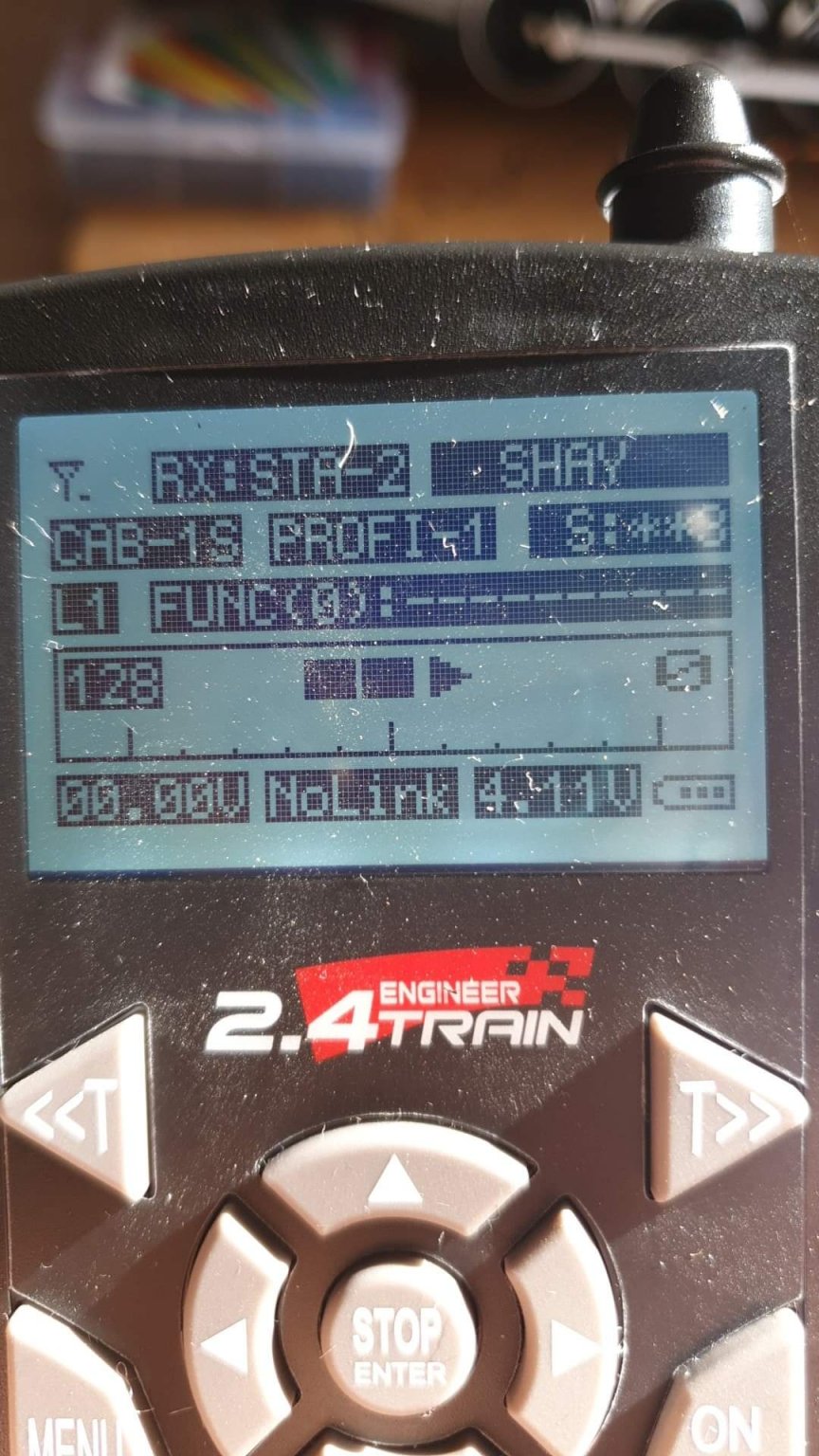

If anyone here is using the Revo DCC handset with more than one loco/receiver, can you advise whether this is correct. Because I'm more and more convinced it is....
I have Loco1 bound to the receiver in it with Rx Station ID 1
I have Loco2 bound to receiver in that with RX Station ID 2.
If I call up Loco1 on the handset and then want to move to Loco2, I can press T>> to tab to it.
Sure enough the loco cab and profile details will change to that of Loco2 but the RX Station ID doesnt!
This seems to defeat the whole point of switching between locos?
I'm order to switch control between locos, I must tab to the loco and then go to another menu and switch the RX station ID.
Mad or what? That can't be right, can it?

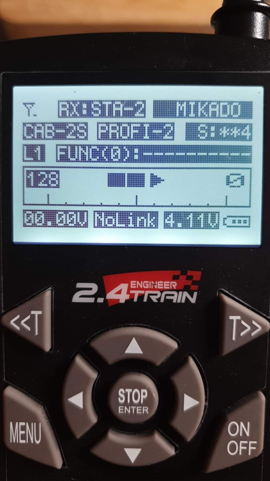

Gotcha. Yes that's what I'm doing. Here are my Cab and Profile changing as I tab between them. Note though that the key communication parameter - the RX Station ID doesn't alter.
(Just to note - the bindings themselves are retained fine, as you'd expect)
I've spoken to Revolution and amazingly that seems to be the way it works. It's designed around a track-connected RX as Hutch has it; put the Rx in the loco and you will need to go in and change the RX id every time you want to change locos.

As I understand it Greg (which may not be altogether correct...)
Each profile is a unique, named object assigned to the DCC decoder and an RX Station ID
You assign one or more loco profiles (as opposed to accessory ones) to a cab, which allows for consists
You then switch between cabs using the <<T and T>> tab buttons, which will also switch the underlying profile
The issue I had is the handset previously expected the RX ID to be global. With the new update, the RX Station ID should be stored to the profile, allwing it to change dynamically.
It remains to be seen how quickly the switch can occur but my experience so far in establishing a new link is about a second
JK mailed me this morning to say he's just released v1.14 of the firmware which will now offer both TX-To-Track or Tx-To-Loco modes of operation :inlove:
