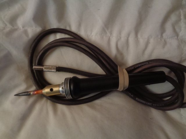

Recently, I've been experimenting with Resistance Soldering. I've tried different power units, probes, tweezers and electrode materials. At this point I'm on the low end of the learning curve. My last test involved a modified probe. Originally a wire stripper with two leads to the power unit, I removed the internals and machined a brass holder for a five millimeter carbon electrode (see attachment.) 004.JPG Testing with different shaped carbons at wattages ranging from 130 to 250 on small .020" thick brass squares and tubes yielded results that ranged from damaging the brass to good joints with the solder melting almost instantly.

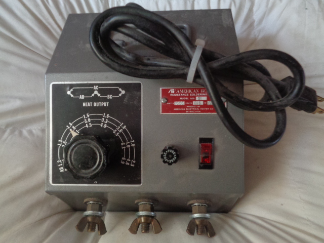

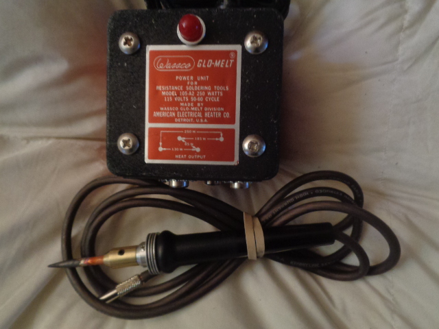

I've been using a Wassco 250 watt unit. I also have this American Beauty 1000 watt unit (see attachments.) As of now. The small American Beauty tweezers I have were too light, as was the American Beauty probe with the .060" stainless electrode. Neither of which are pictured. The probe with the five millimeter (.200") carbon electrode seems correct. The problem I'm having is control of time and heat. I did find out that both ground and electrode need to be as close to the joint to be soldered to avoid heat to the adjacent soldered parts. The resistance soldering tools are very effective in this regard. Outside of the area between the ground and the probe, there is negligible heating. 001.JPG 005.JPG

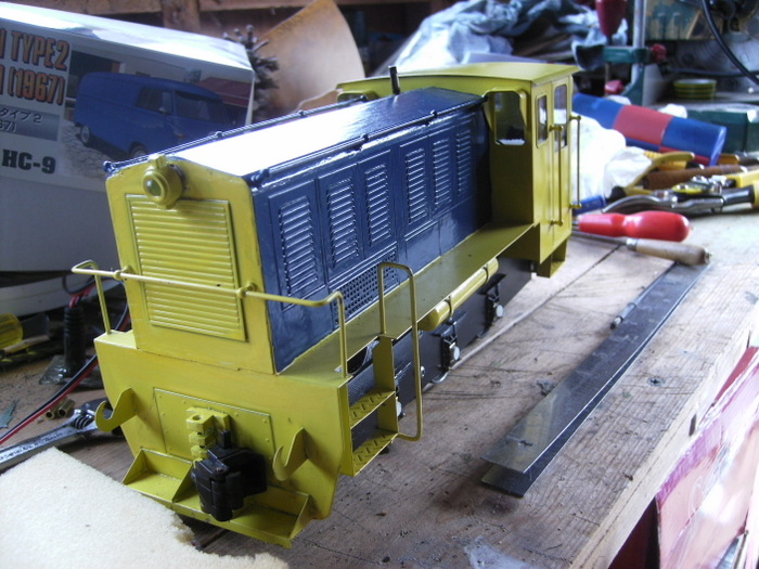

I was using a standard 50 watt soldering iron, 145 degree solder (standard resin cored solder is usually 220 degree melting) and liquid flux (Carr's product).
I must admit that, being a Luddite and devout bodger, I've not gone into the technicalities of resistance soldering. I don't have any piccies of the smaller models as they were before digital photography, but the nickel silver blue and yellow diesel which is all soldered by the same method is here.
At the last house, this loco took a 2 ft plunge off the track onto a concrete paving slab - and largely survived. I put it down to the nickel silver having a bit of flex, and the soldered joints holding firm - it's still running, only about to be named Yeti, as in yetinother gearbox - this time a rather more robust, elaborate and more expensive quality item :emo:

Very kind of you to say so, John.
When I made it, I knew that the camera would do me no favours, so I had to curb my natural impatience. I held the corners with blue tack, then spot soldered. Only when I was happy that the alignment was perfick, did I run the solder down the entire joint.
