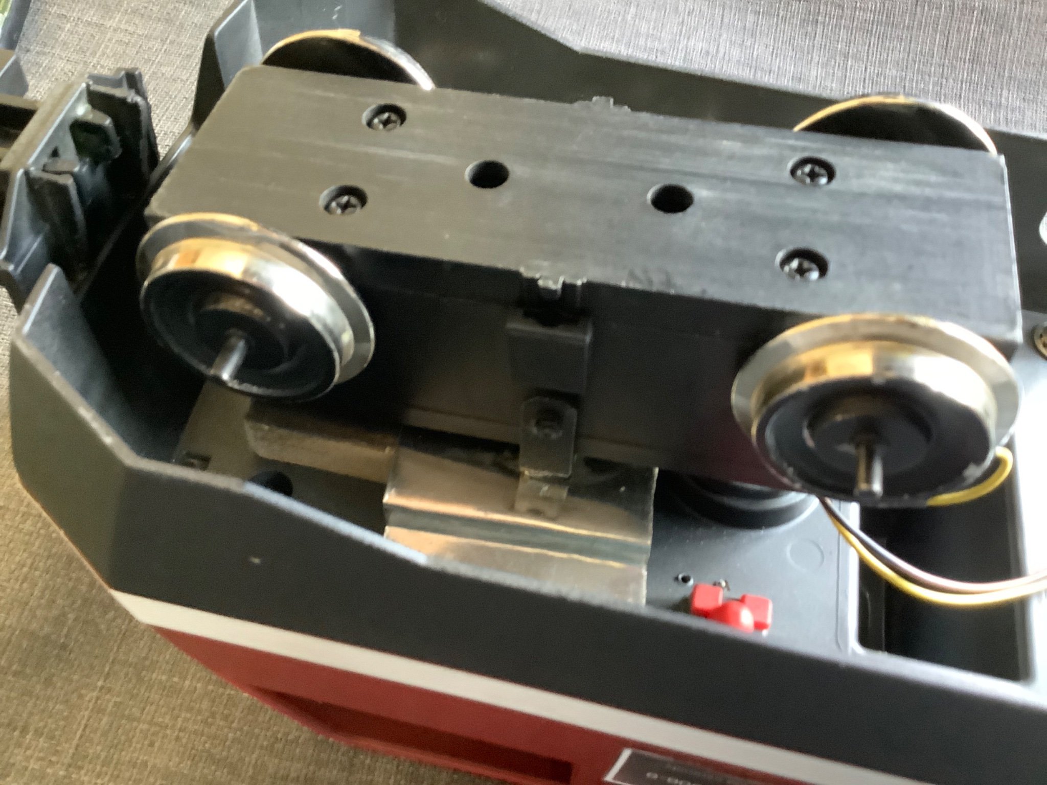

I tend to use the end screws to place some metal over things to put the motors in place, but also short screwed metal pieces to the sides. Most important to get those screws small so not to disturb innards and ensure no swarf inside the chassis.. Have a look at post 14 on this thread to see how I have done it, I think a wider pair of L shaped either side should work for you.i did mine like this so that the bogie would rock end to end the other bogie being made to rock sideways giving me 3 point compensation on a bogie loco conversion.Hi all,

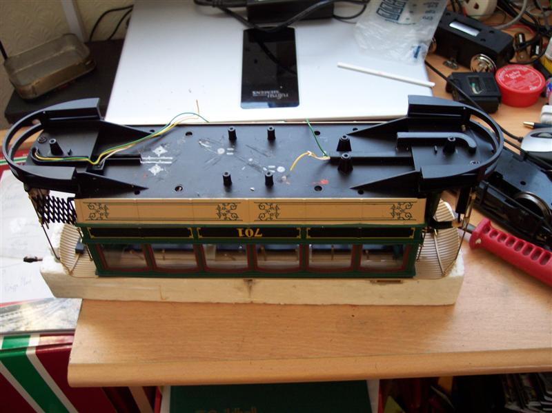

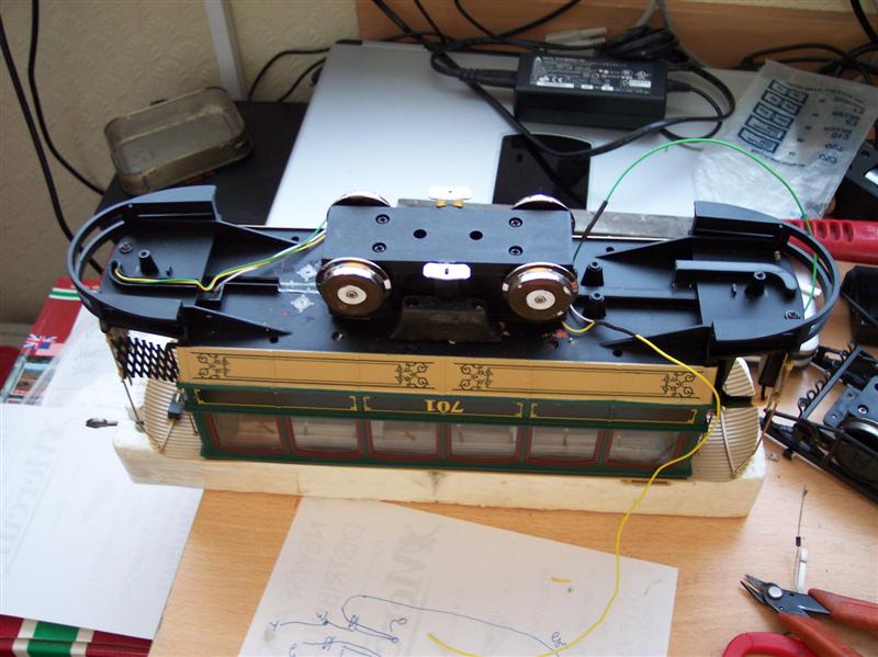

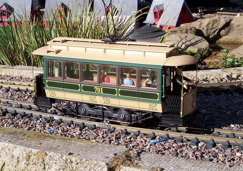

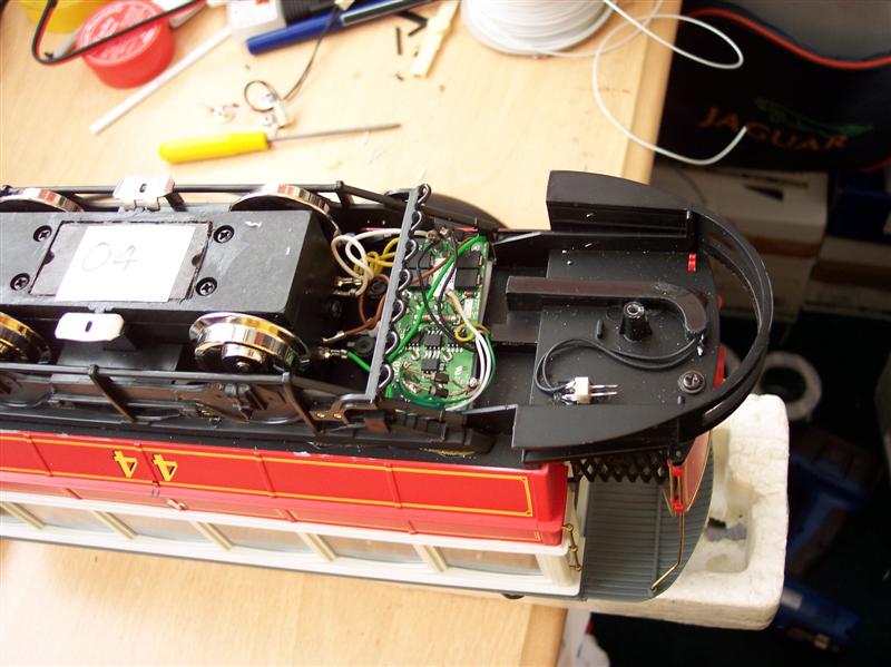

Dutchelm had a thread back in 2009, but the pictures are all lost. USA Trains power bogie I have a copy of the relevant parts of the thread and can send it to you with Dutchelm's permission.Hi all,
I have a friend who is going to replace a Bachmann motor block on a streetcar with a USA trains one, is there a thread anywhere which explains how to do this?
Thanks Sam
This really was an excellent "how to" on re-motoring a Bachmann tram. I have one with a failing motor and made a copy as I was sure to need the info at some point and have observed how easily photos seem to disappear from articles. I'm not surprised that you were able to find your own photos, but I'm amazed at how quickly! Takes me days to go through my stuff. Thanks again for the original article.A couple of pictures that were on the write-up on Bachmann tram mods.
