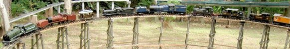

When the Sydney Harbour Bridge was built, they load tested it with MANY locos.
(pic from:http://sydney-harbour-bridge.bos.nsw.edu.au/engineering-studies/testing.php)
So the Sandstone and Termite decided on a similar test, when the repairs to the big timber trestle were completed..
This video shows it better. [size=12pt]http://youtu.be/U-9ZjaK52jA[/size]

That's an impressive line up of motive power...

I've always wondered about those old bridge testing photos - what if they got their predicted load figures wrong? Not only would they lose the bridge, they'd lose one heck of a lot of motive power!........ :( :'(
Rik
PS - Great line-up Greg :happy:

The SHB testing was in the depth of the Depression, and I've been told the locos were all on the 'condemned' list.
If you look at the link below the pic (I didn't make it an active link, so you'll have to copy and paste) you can see a really interesting pic where they loaded one end of the SHB and measured the deflections. They then plotted at an exagerrated scale the effect - looks wierd!
