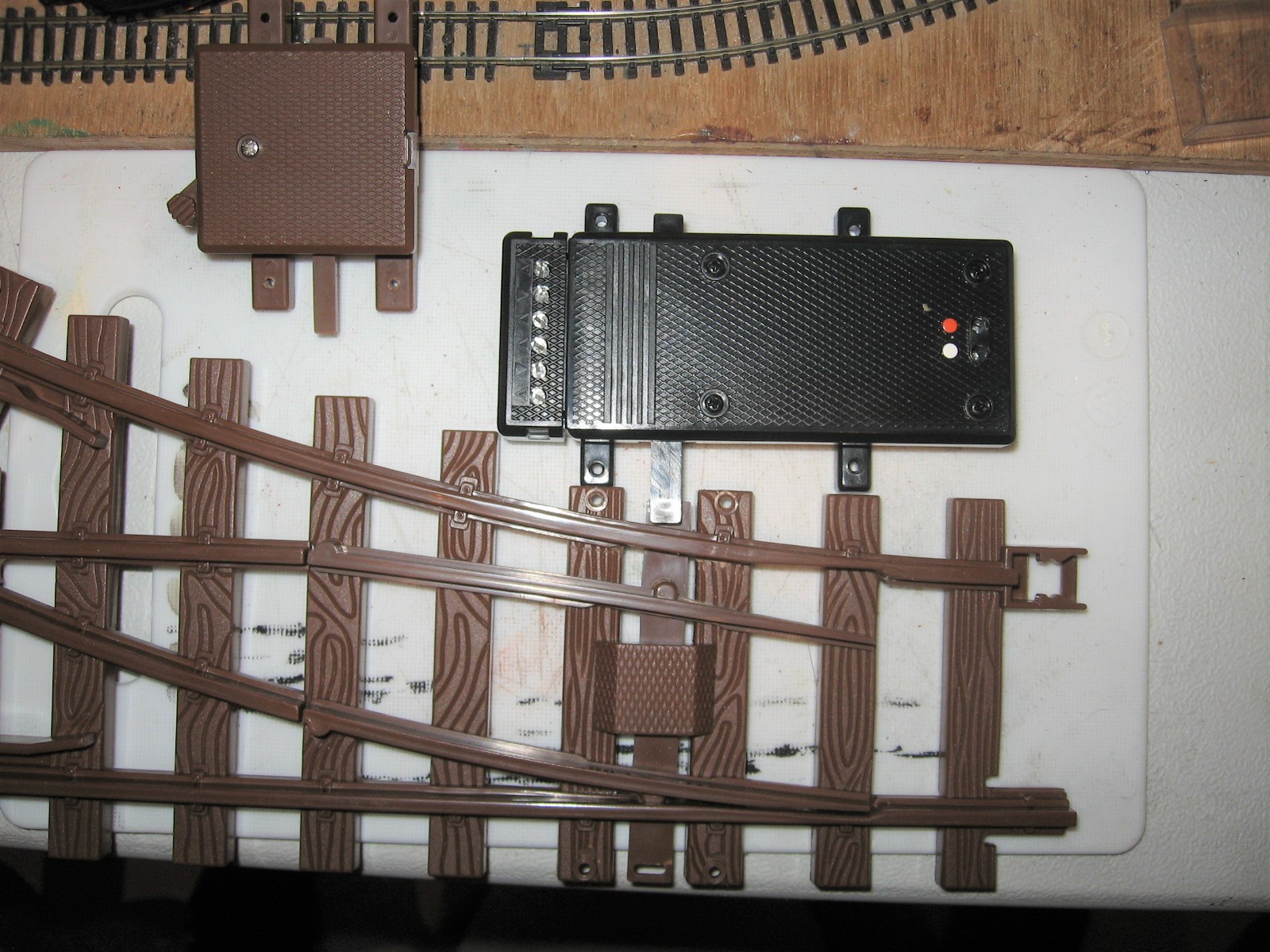

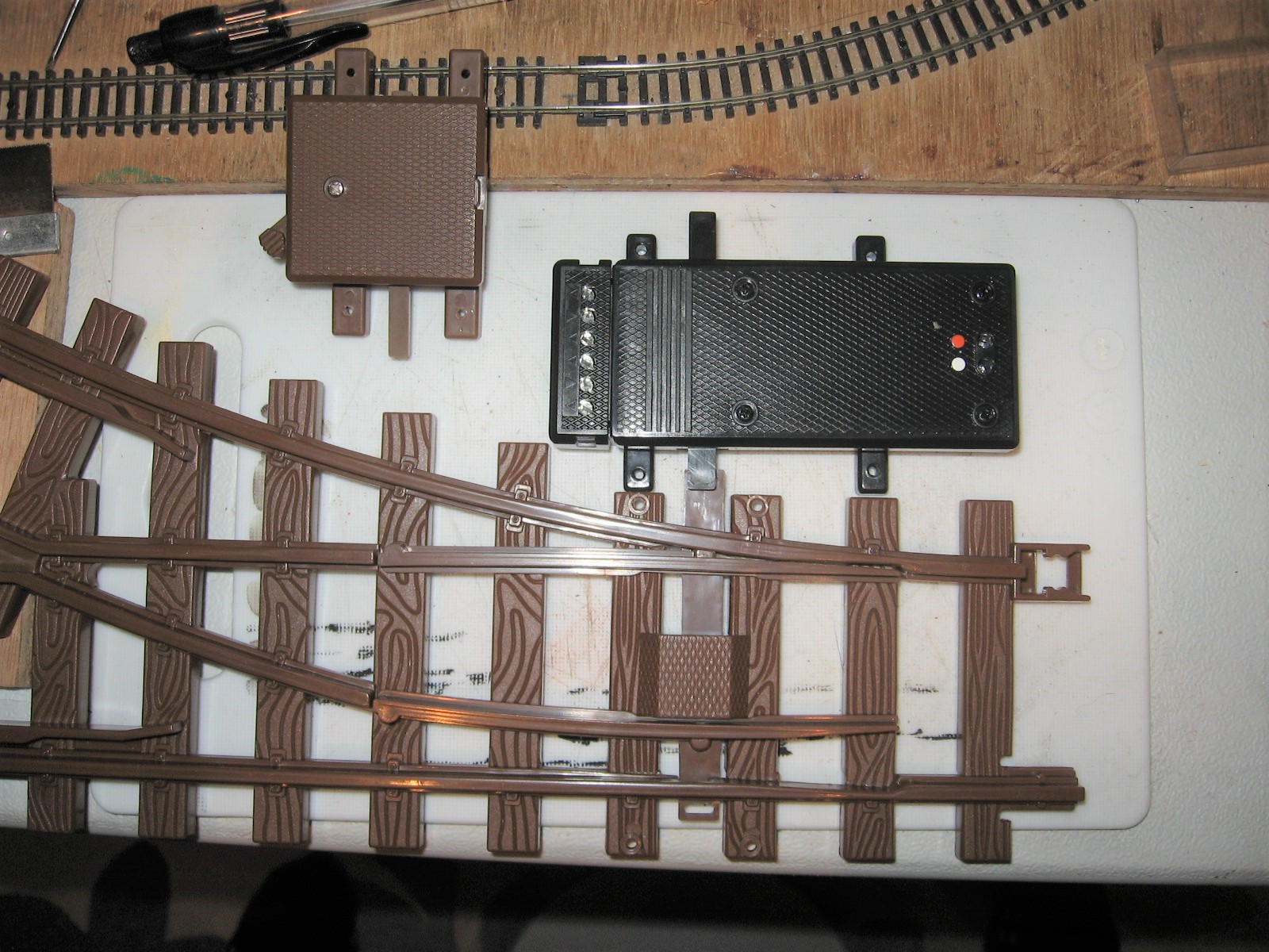

Right... I've dug out an NQD point, removed the manual lever and offered up an LGB point motor.
The "12mm" throw quoted before must have been measured from the tips of the blades, the throw at the tiebar itself is 9-10mm on my example.
I reckon an LGB motor will "just about" do the job, though notice that it needs to sit butting up to the ends of the sleepers: the mounting holes don't line up with those in the sleeper ends to which the manual switch was fitted. Would probably benefit from warming and bending the tips of the blades just a little to ensure they are fully flush with the stock rails. If the Piko equivalent motor does indeed have a slightly longer throw then that would be a better choice I think.
