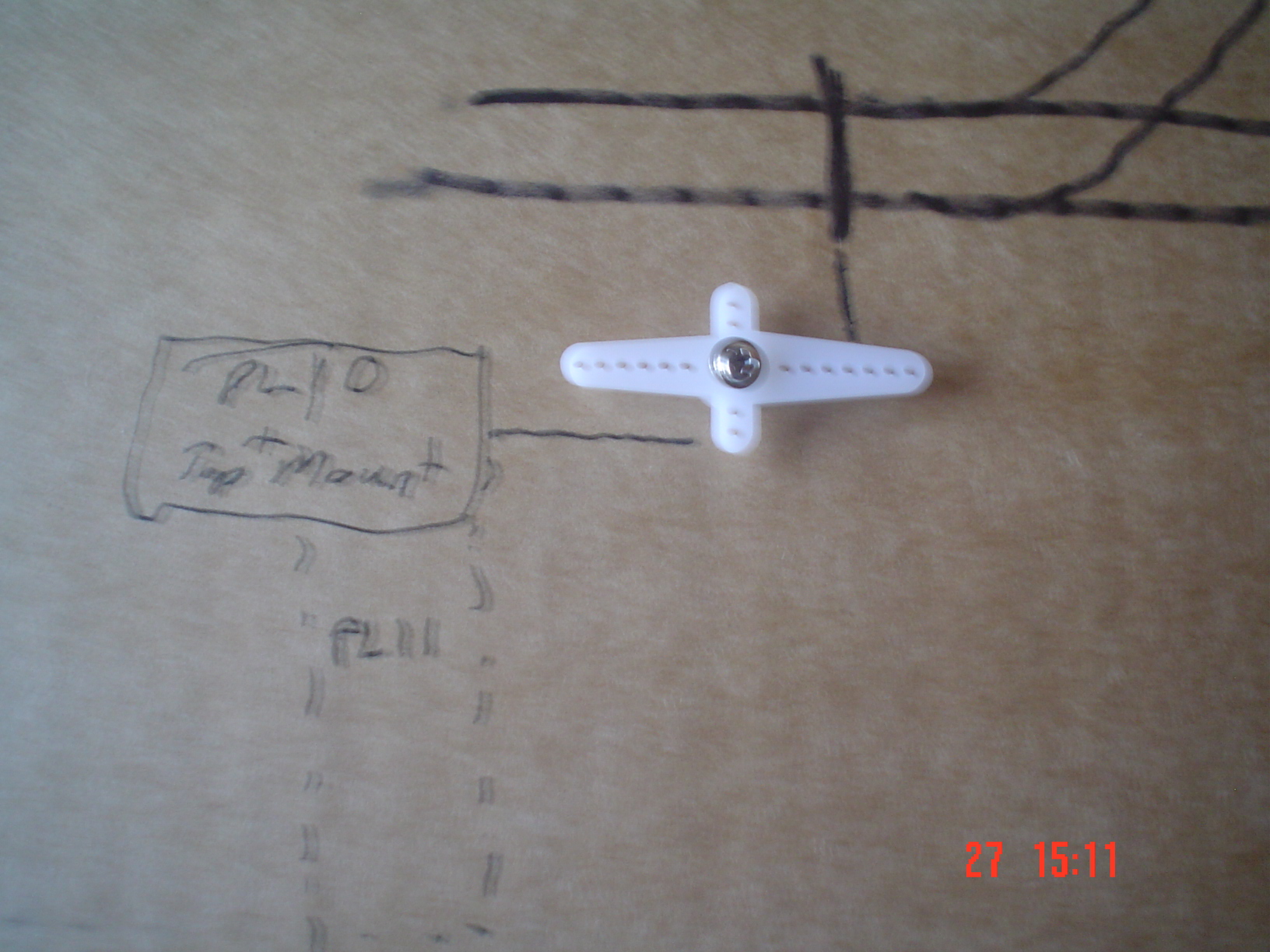

You will need to fit a 'bell-crank' to increase the throw..
You can cut the 'bell-crank from an offcut of plastic, and use a screw and washer for the pivot. - I happened to have a 'horn' from a servo kicking-about..
The motor drives the short-leg, and by uses a hole further from the pivot, you get a greater throw to the point.. If you have nothing else, paperclips are a source of firm wire to make the linkages..

Phil's suggestion of a bell crank (a right angle arm pivoted at the angle) means that if you have a shorter arm to the point motor, you then use a longer arm to the point mechanism and that will give you a longer throw. It's back to yer school physics EFL, FLE, FEL - in this case E is the short crank (with the rod attached in the picture) F is the fulcrum or pivot screw and L needs to be the furthest hole on the other arm >:)>:)>:)>:)
