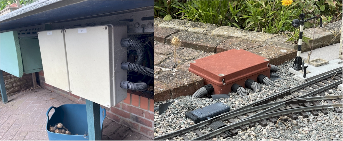

Like others, I would endorse using weatherproof enclosures combined with flexible conduit, to provide protection from weather, wildlife and UV. I have a lot of cables and so have several boxes situated around the garden, as nodes for signals, points, track power, lighting etc.
Like others, I would endorse using weatherproof enclosures combined with flexible conduit, to provide protection from weather, wildlife and UV. I have a lot of cables and so have several boxes situated around the garden, as nodes for signals, points, track power, lighting etc. View attachment 345602
I can confirm the thought that has gone into Martyn's line with many boxes and conduit pre installed before track laid. Fortunately (I guess) he will have some spare former track power wires due to going Battery Power.
