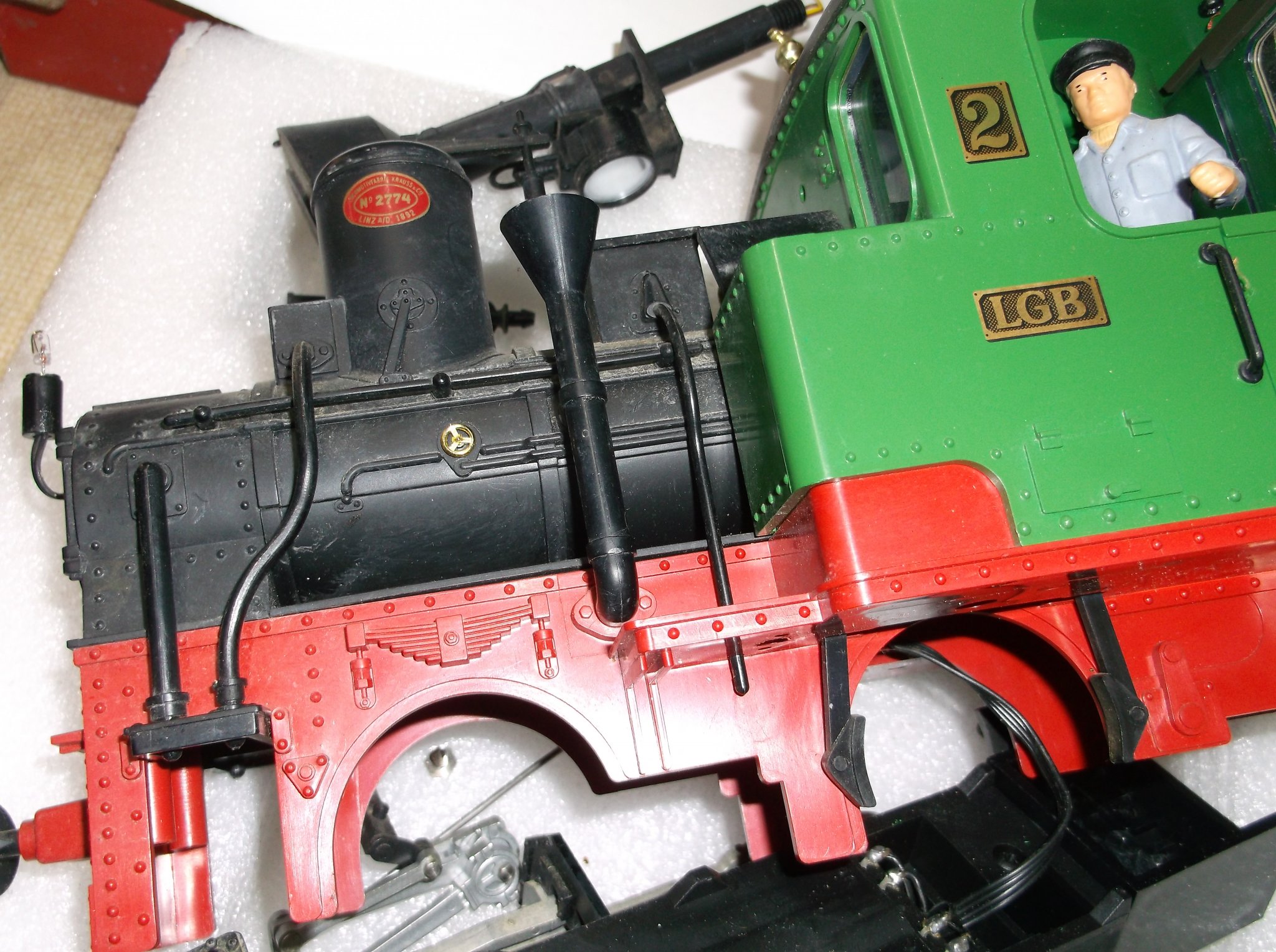

The pipes either side of the smoke box, pull out from the chassis.
The water filler funnel, pulls out at the bottom, and the? Safety valve-thing? In the front of the cab, pulls out of the cab, and up out of the boiler.
I *think* that is it?
The boiler is then squeezed/twisted, to separate it from the cab..

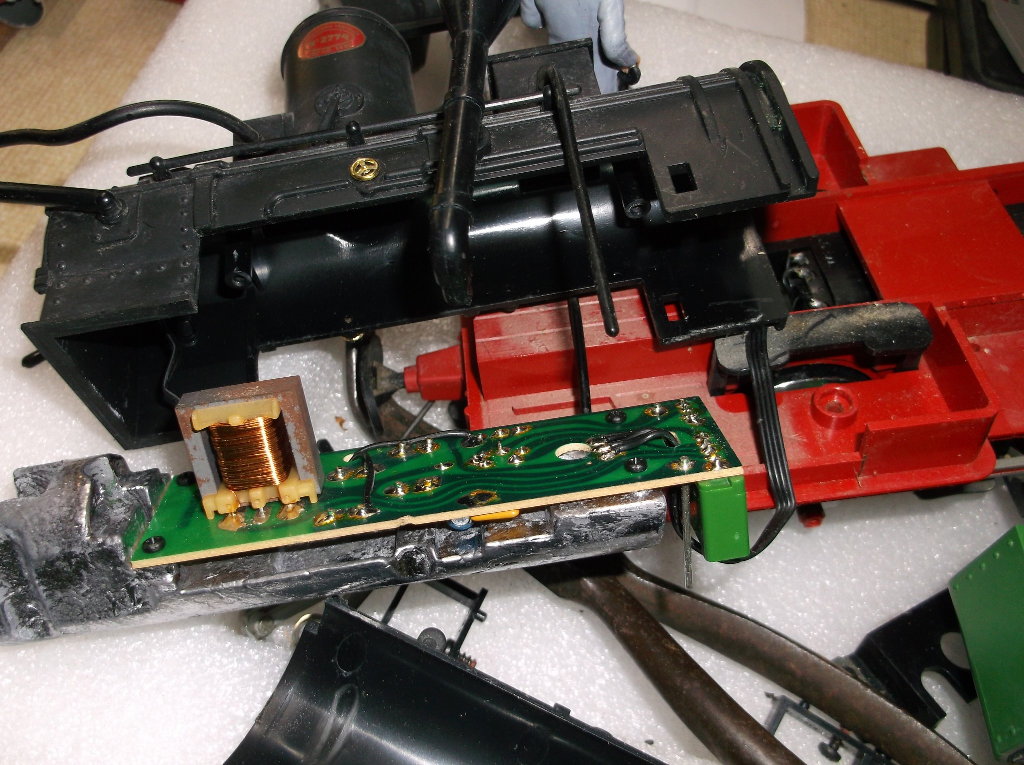

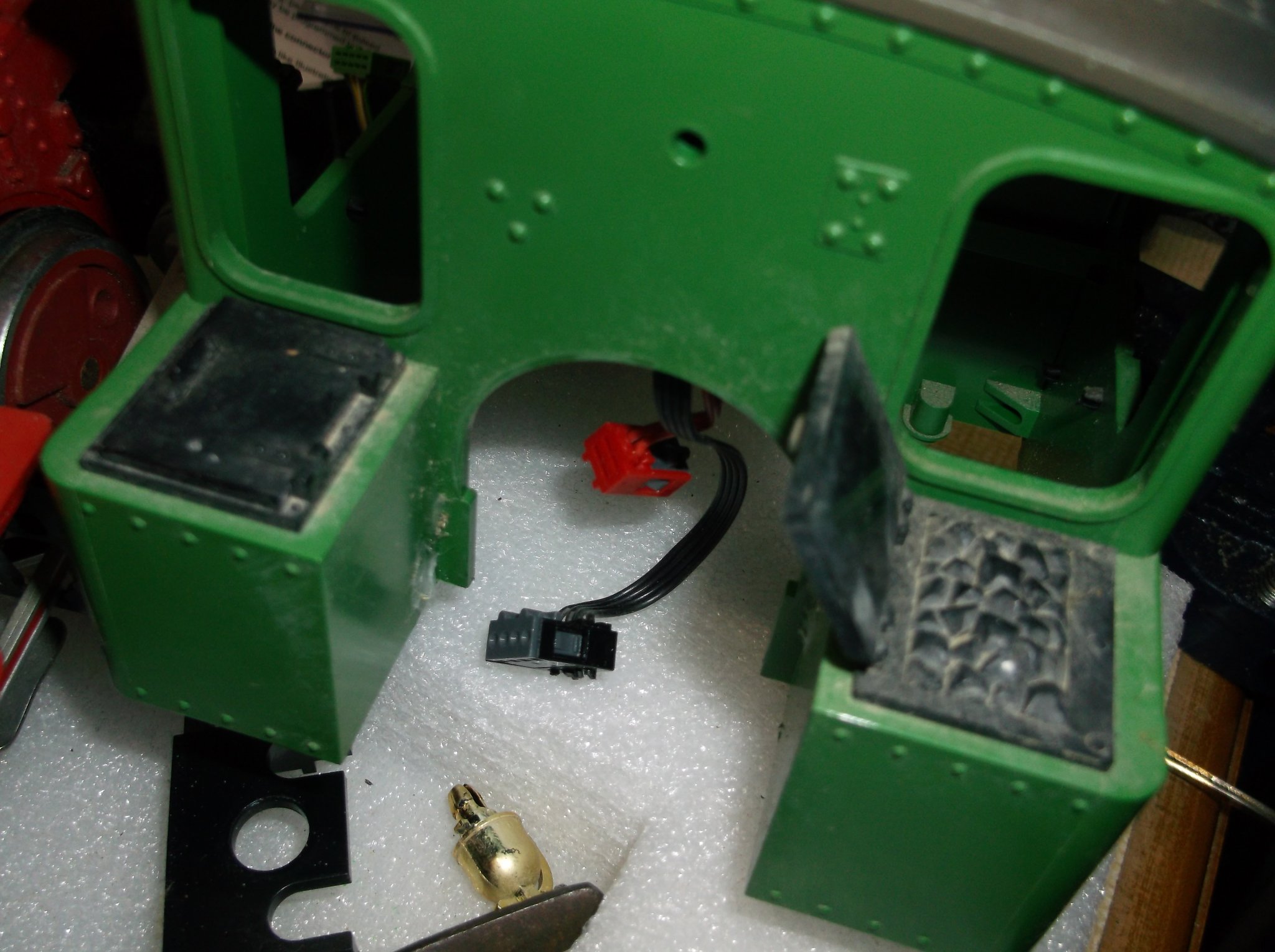

Yes the boiler cab end has to be squeezes or prized with a small flat blade screwdriver to pop the boile from the cab it doesnt slide up and out as one would expect from the groove it is in. then anothe judicious use of a small flat balde screwdriver to pop the bottom off the boiler you cant press the lugs in as i would have wxpected.DSCF1566.JPG
As someone said the Gremans must have a sence of humour if this is the assembly of their basic starter locamotive, Full admeration for the though that went into it. GOD now what am i going to do with all these parts?? i cant remember why i took it apart now>
