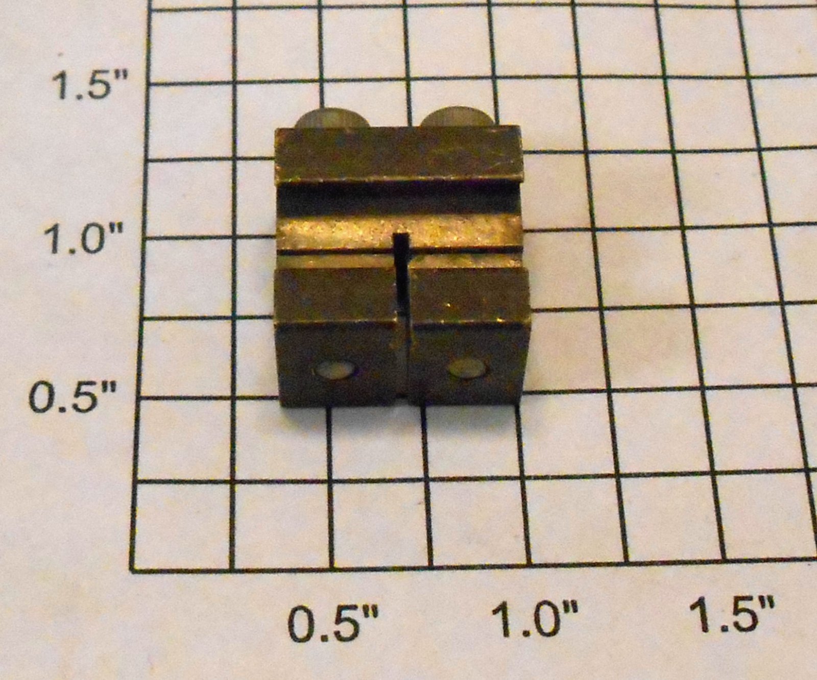

You are after something like this?

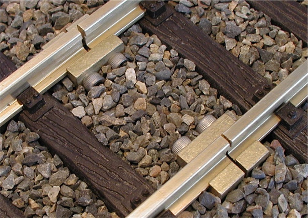

In UK to the best of my knowledge these days the only Track Clamps that are readily available are Massoth. These require the LGB fishplates to be removed and are held in place by tightning the screws supplied. None of the Track Clamps are a cheep option but they do all give a reliability of electrical connectivity that is second to none. My complete Railway with just a few exceptions is fitted up with Track Clamps of Hillman (about the only ones available when I started to use them) and more recently Massoth.
Down side os that Track is not lifted immediately, up side is that they give adde security. Who is going to wander down the Street in the dead of night with a great big loop of Track? The effort, time required to undo the joiners would just make all but the most determined thief walk away.

I have to agree with Greg and others here. Rail clamps are the way to go. In the States, Split Jaw are arguably the best. But I've seen the Massoth, and use their insulated clamps. I assume their standard clamps are the same quality and would also recommend them.

Jon, I would have to differ with you on this. To me, removal of a section of track that is fitted with original track joiners requires lifting several sections in order to get enough slack to separate the track sections. With track clamps, Split Jaw in particular, all I have to do is loosen one side of the clamp and lift the track section out.
