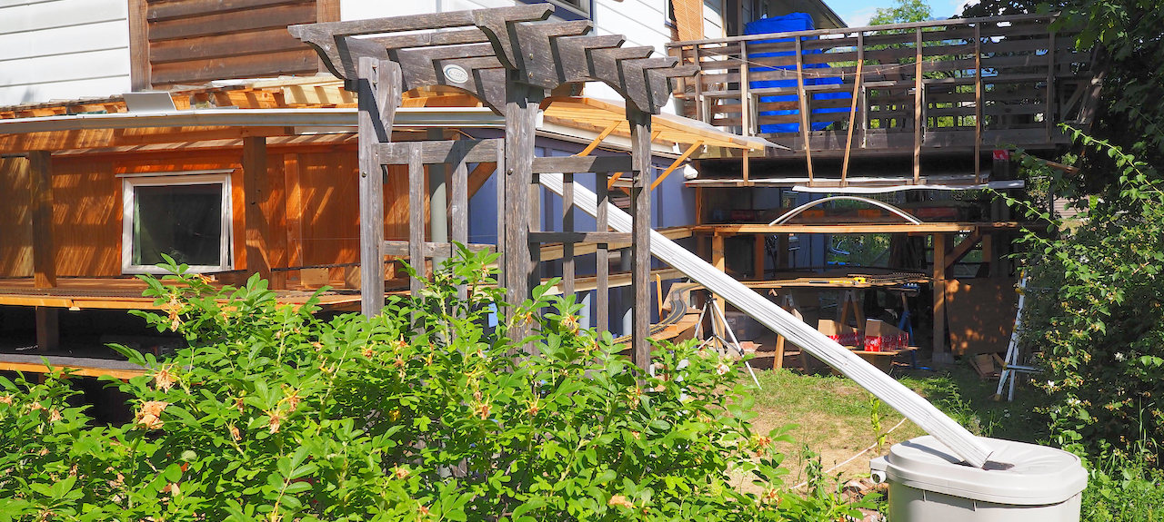

My 'main line' leaves from a highest level below deck leads along the house wall to a former fire wood storage with two levels, hence a back and forth 3 times (see layout sketch).
So, yes, I aim for somewhat realistic operations (the uncoupling at this time a wish-list item). As the acquaintance mentioned before is experience with Revolution Train Engineer there is a bit of a tendency toward that remote. There are other options, maybe that CVP Airwire900. Looking at the helpful blog Peckforton Light Railway I do see still more possibilities. However, I am not an experienced electronics assembler. I need pretty well a fully assembled receiver with a fair offering of features and - no small job for me - and then I need to prepare the loco, drop in that receiver, reassemble, and hopefull enjoy a successful test run. No doubt, I will be glad to call on a helper ...
I listend to quite of few of your sound samples. Steam would seem most fitting, diesel maybe as well. Arises the question whether there might ever be an option to 'flow' my own sounds onto a card?
In order to match the layout sketch with the overview photo you'd have to turn it 90 degrees clockwise. Under the deck there's the main station 'Ramosch'. In reality never got one as the line beyond Schuls/Scuol in the Engadine, Grisons Canton, was never completed to Landeck in North Tyrol due to the outbreak of WW1. Obviously my Landeck Graubünden Bahn profits from the notorious 'rubber scale' for which tho' some criticize LGB.

So, for the next little while from beneath the deck to the former firewood storage, back and forth a couple times, will continue to circulate the European LGB models, analog and happily (dealing with one Y and one turn loop, some sidings/by passes and very few blocks), ...happily especially when I finish the last bit still under construction.
So far, from beneat the deck to 15ft beyond the upper station at the firewood stack, track proved no problem. There are several feeds and of course every now and then some cleaning is needed but no pain as yet.

...well, yeah, not really an out in the garden RR, an along the house and under cover fancy. But then there's that somewhat distant K & S Ry project :cool:
