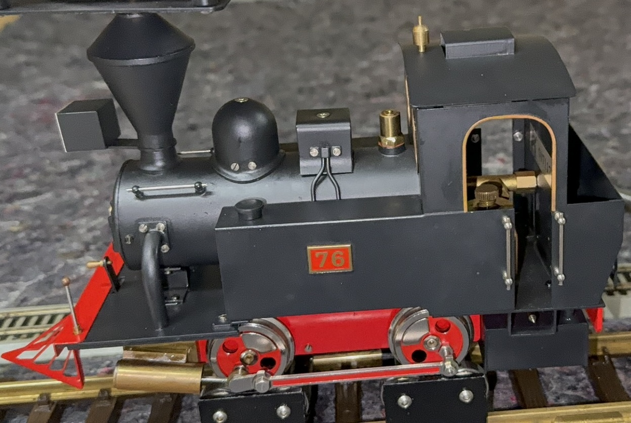

Instead of asking daily questions about my new Aster Old Faithful, perhaps someone on this forum has more information about this Loco. I’ve searched unsuccessfully for the correct safety valve/gasket sizes and where to find one that can be produced. Given the engine’s 51-year age, I found limited information.
I don't know if data sheets exist for these, so let's work from first principles. The advantage is that you'll get to learn about your loco. Take small steps and never take anything apart that you can't get back together. If it is leaking steam, you may need to get some gasket material (often called 'gasket paper', but it's more substantial than that, and not paper-based, either) and some paper punches; and then make your own. O-rings should be nitrile, I believe, and will be either obvious Imperial or obvious metric sizes. If you haven't got a micrometer or vernier callipers yet, I would get one: digital verniers are comparatively cheap and simple to read. Taking locomotives apart, and reassembling them, isn't difficult, but you  do need to be careful! Don't force anything; threads are very fine and can strip easily! Some will have threadlock on them: this can usually be softened with gentle heat (cook shops sell small blowtorches for caramelising food, which are ideal for this. Always work on a tray, with a towel laid on it: small parts can travel a long way when dropped... How do I know this?

No, thank you for the long post. I wish it was longer question. I do have a calipers. The problem is the threats. I know nothing about machining. I would pay somebody to make some safety valves. If I could figure out how to get the thread sizes for them do you know of any shops that could assist me with getting the size and having them make them for me I’m talking about safety valves. Please let me know. Thank you by the way I live in USA.

The key thing will be to know what size the threads are. You won't need a new safety valve machining: you can either replace the gasket or ball in the one you've got, or buy a replacement. In the US, Weebee have a good reputation, I think.
Jason Kovak at The Train Department is enthusiastic and helpful, and his website lists lots of steam spares.
