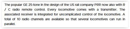

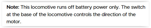

The Gaugemaster website offers both the yellow and red versions. Both are described as "Battery Powered RC" but look at the price differential . . .
The description of the red one says . . .
The description of the yellow one just says . . .
Finally, the Piko website mimics that price differential and doesn't include "R/C" in the title of the yellow one . . .
