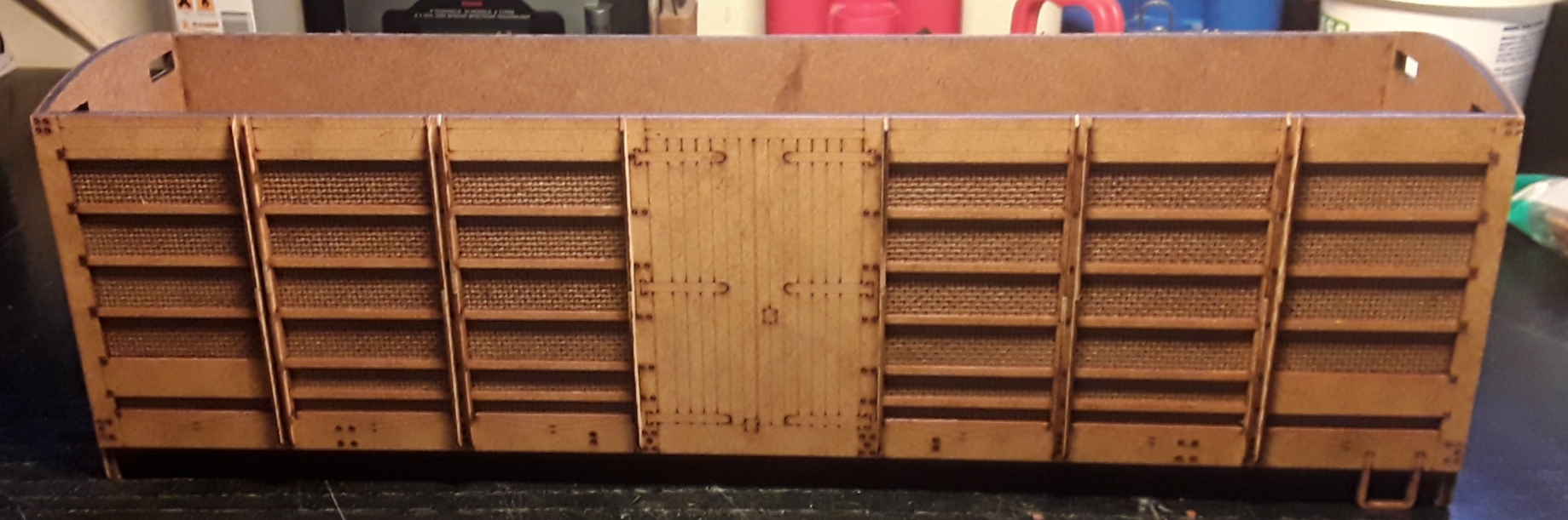

After 15 months I've just got started on the first of my Resurgam made SAR kits. This is the first time I have worked with MDF. Question - seal the individual components before assembly ( with either PVA or CA ) or after as complete sub assemblies before priming and painting as usual before final full assembly ? My concern is that the sealer will act as a barrier and my not allow a full bond from any adhesive I may use as a result. Got me a tin of Rustins as advised on here previously, can it be airbrushed ?
Little picture of one major sub assembly. I am amazed at the accuracy of fit of the components and the detail that they contain. Max
