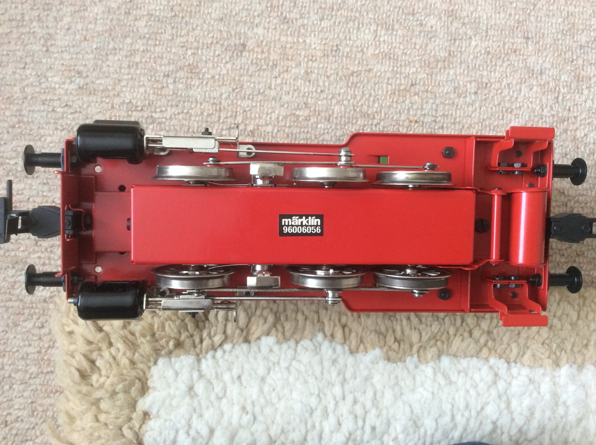

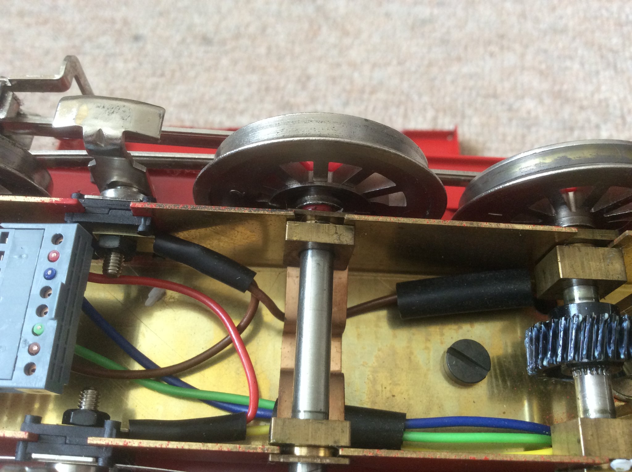

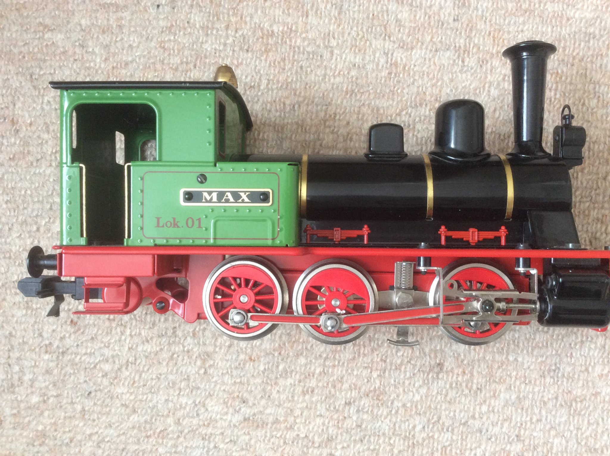

Details of the Max Lok 01 060 steam loco chassis.
It is made from metal, 0.5mm steel? frames, mainly screwed together. The front two axles pick up power from shiny silver discs behind the spokes, along with a pair of sprung sliders. The rear axle has no power pickup, this has the worm drive, and a pair of traction tyres. All axles are in bearings, the centre pair are sprung.
Running qualities, because of the short wheelbase and shallow flanges, long plastic frogs such as found on LGB R5 and Piko curved points cause stalling.
LGB R3 seem fine, not yet tested on R1

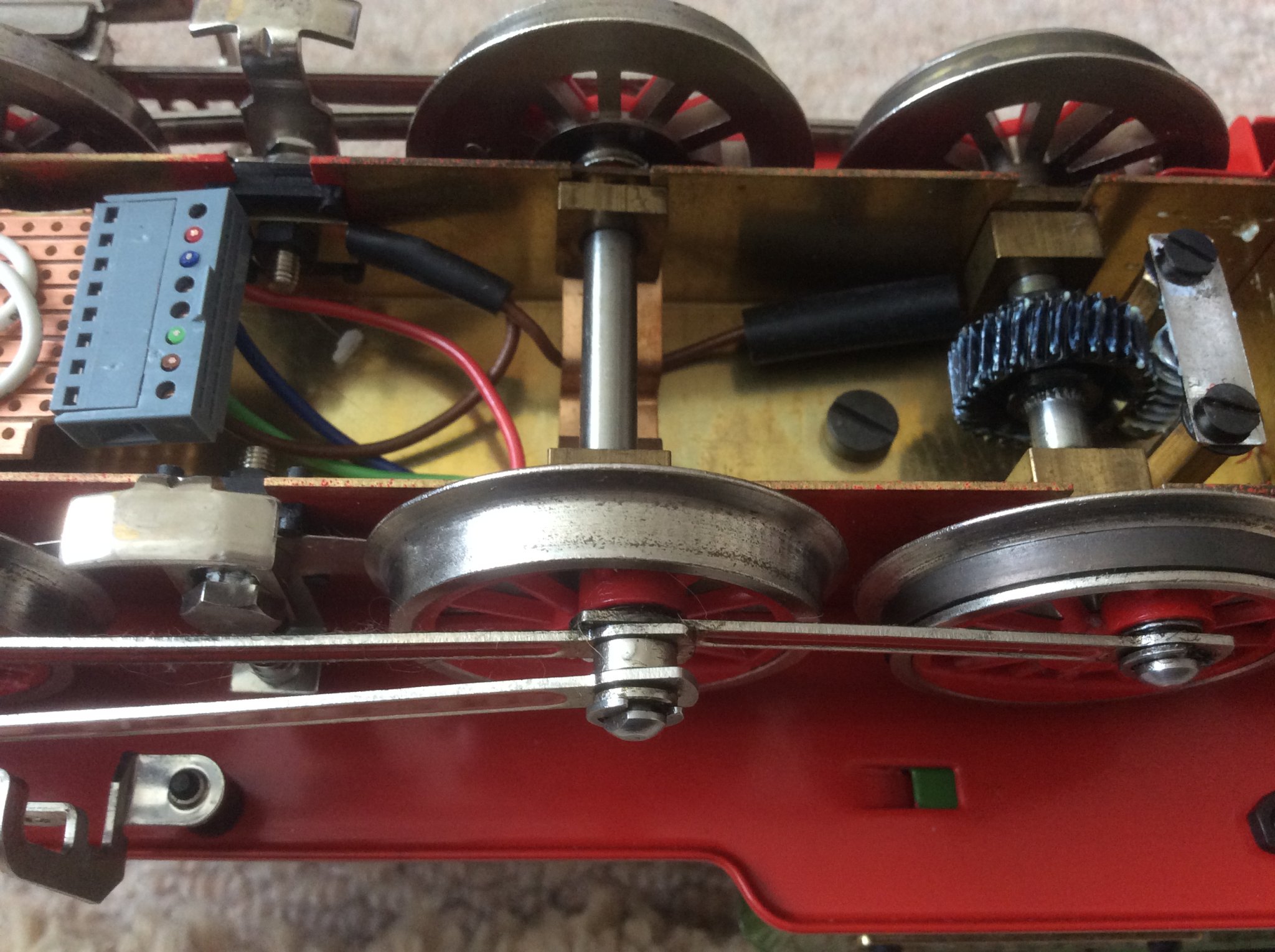

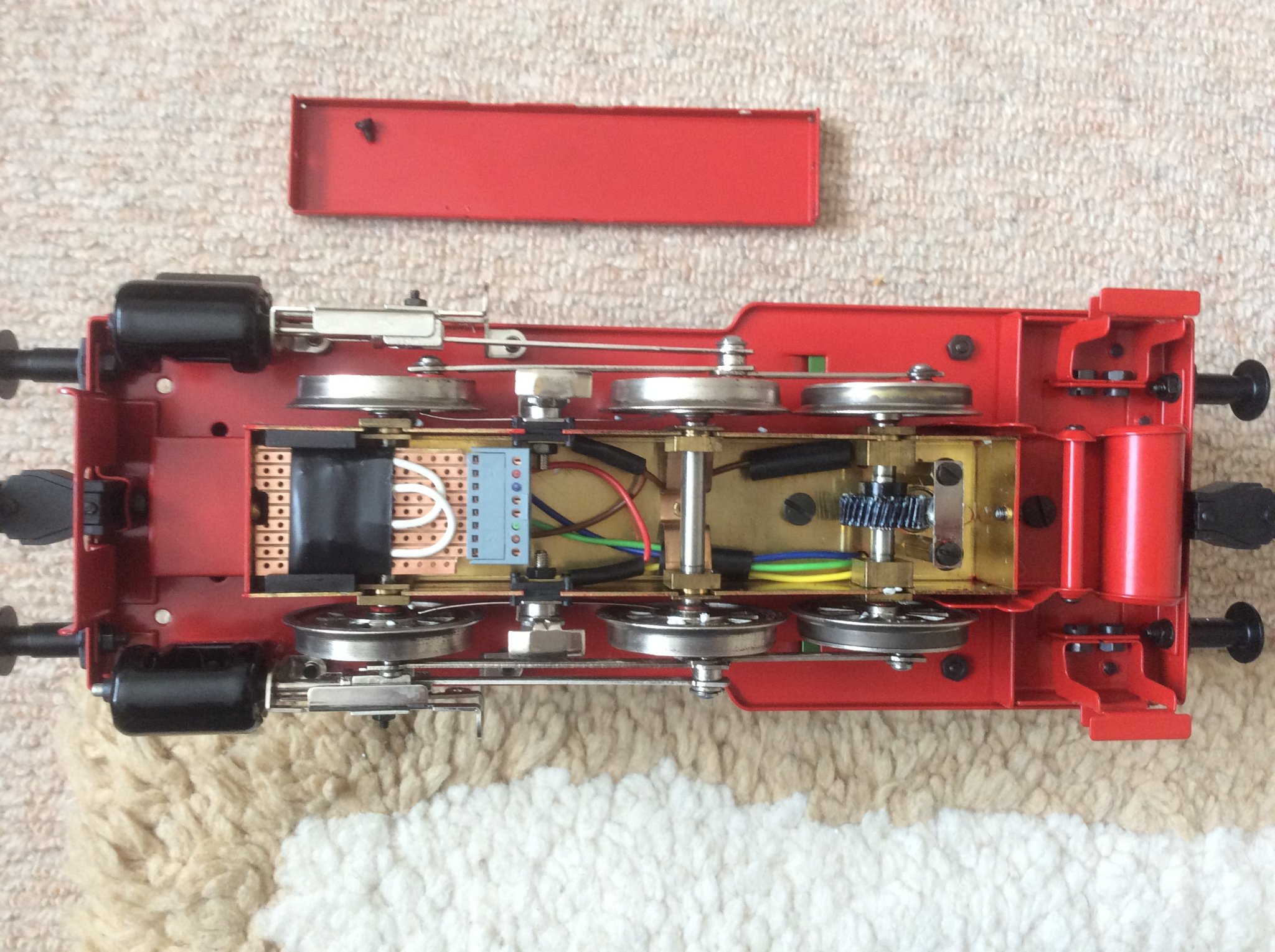

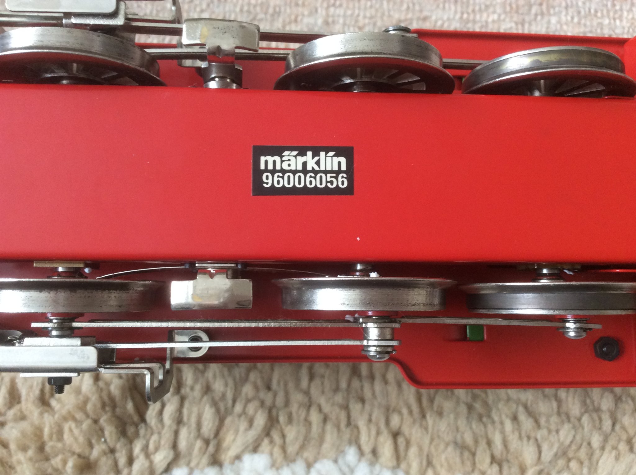

And some more details.....
Brixham
27 Aug 2010
1,495
120
The couplers have actuating arms which are very close to railhead level, on one R3 point the loco jumps, I think the front coupler is catching a switch rail. The mechanism is very quiet, and as it has a 12 volt motor, moves before a straight analogue LGB loco. Top speed is fine. Weight about 1.5 Kg, maybe more.
Hauling power, as yet untested.
I tried the smoke, but may have overfilled the chimney! The smoke is controlled by a toggle switch in the cab.
