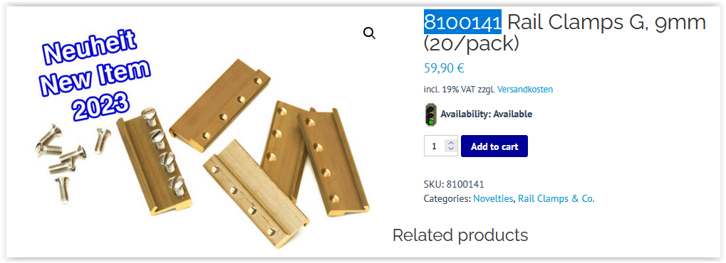

I note that Massoth is offering LONG rail clamps . . .
Not only is there a typo on their site (I believe it should say 39mm rather than 9mm), I also seem to recall them being earlier than 2023 (though maybe this is a re-issue "with improvements").
My garden is on clay, so my line is prone to movement (sometimes getting longer ** and sometimes shorter again). Once the gap between rail ends becomes too great, I have taken to adding a very short piece of rail (in case it moves the other way and can be removed again), and fixing this with two rail clamps. The longer clamps would be a tidier way to deal with these locations. The problem I have is that the Massoth clamps are made to fit LGB (etc) rail, and much of my line uses Tenmille track. I have found a way to make Hillman clamps (for LGB rail) work on Tenmille rail but don't know whether the same approach would work with Massoth clamps. I'm therefore reluctant to splash out over £50 to buy 20 in case the method doesn't work . . . so I was wondering if anyone had already bought a bag of 20 but only used a few of them, and could be persuaded to sell me one or two?

I can't help with supply, but the longer clamps have been available for some time. - I have a 3 foot length of track, with a pair of these on the end..
The extended length is drilled to take a 4mm banana-socket/terminal post.
It is also easier to get a good connection with a crocedile clip, if necessary, and provides a decent amount of surface to get the meter-probes on.. :nerd:
(I think GRS did/do there own-brand? - They may be prepared to sell in smaller quantities..)
Chalk Garden Rail, are advertising a pack of four, for a tenner!

The original Massoth rail clamps were avaliable in 19 & 29mm versions. I didnt sell many of the 39mm ones during my time running GRO.
The railclamps were reprofiled (improved?) hence they are "New for 23".
