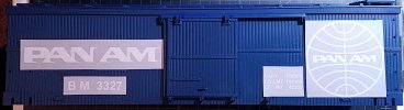

After a long while I am finally able to return to my boxcars!
I have decided to make the ex-Virginian boxcar a simple process and just cover the existing lettering with new. So, I spent last night and this morning creating my decals and then test-fit them on the car. Thoughts?
Once I order the decals the lettering will be white on the blue background. This car will also be weathered eventually; so it will look old and re-purposed.
I have finished my Pan Am boxcar as of this morning. I had some issue with the decals getting lost in the mail. But, after a wonderful interaction with Del at G Scale Graphics, he sent me a new sheet and I have been able to finish this car. It's not perfect; but for my first time creating and applying decals, I am happy.
This car also got a new brakeline (see the nice brass rod on the left!), a quick undercarriage paint-job, and the trucks were touched up. I may also repaint the grab rails black. They have blue paint on them in part.
