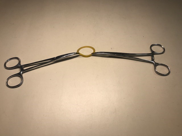

JimmyB - Greetings from across the pond! I concur with prior comments, don't run LGB locos without the traction tires........can cause wear damage to the loco's traction wheel and track rails. Similar to PhilP's technique, I use a miniature-bladed box knief, and putting the blade under the front part of the tire, I move the blade completely around the mounted tire to ensure it's evenly seated. For unmounted motor blocks, I use two clamping tools to install traction tires.......see photo.
Sounds like you have some defect tires which do get brittle with long self-life. I use both the LGB and Massoth traction tires which work well.

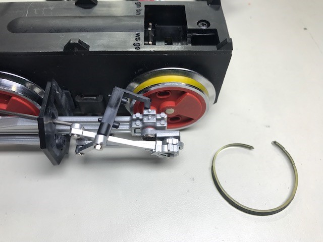

Jimmy - I just fitted the 37.5mm traction tire onto an LGB Stainz that I'm installing a DCC sound into for a customer. I usually install a tire with the inner loop on the outside like I did in the photo below. Actually it should stay on either way. Are you using a 37.5mm tire? The larger 45mm tire used for LGB Mogul etc will probably come off a Stainz traction wheel. Tom
