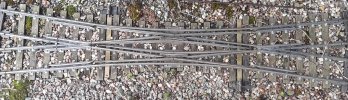

Ah, the wonderous double slip.......
My GRS example, made from LGB code 332 rail. Designed to work with their, off the shelf, 6 ft points or LGB R5's. Saw one on another line and just had to incorporate one into my one. Max
