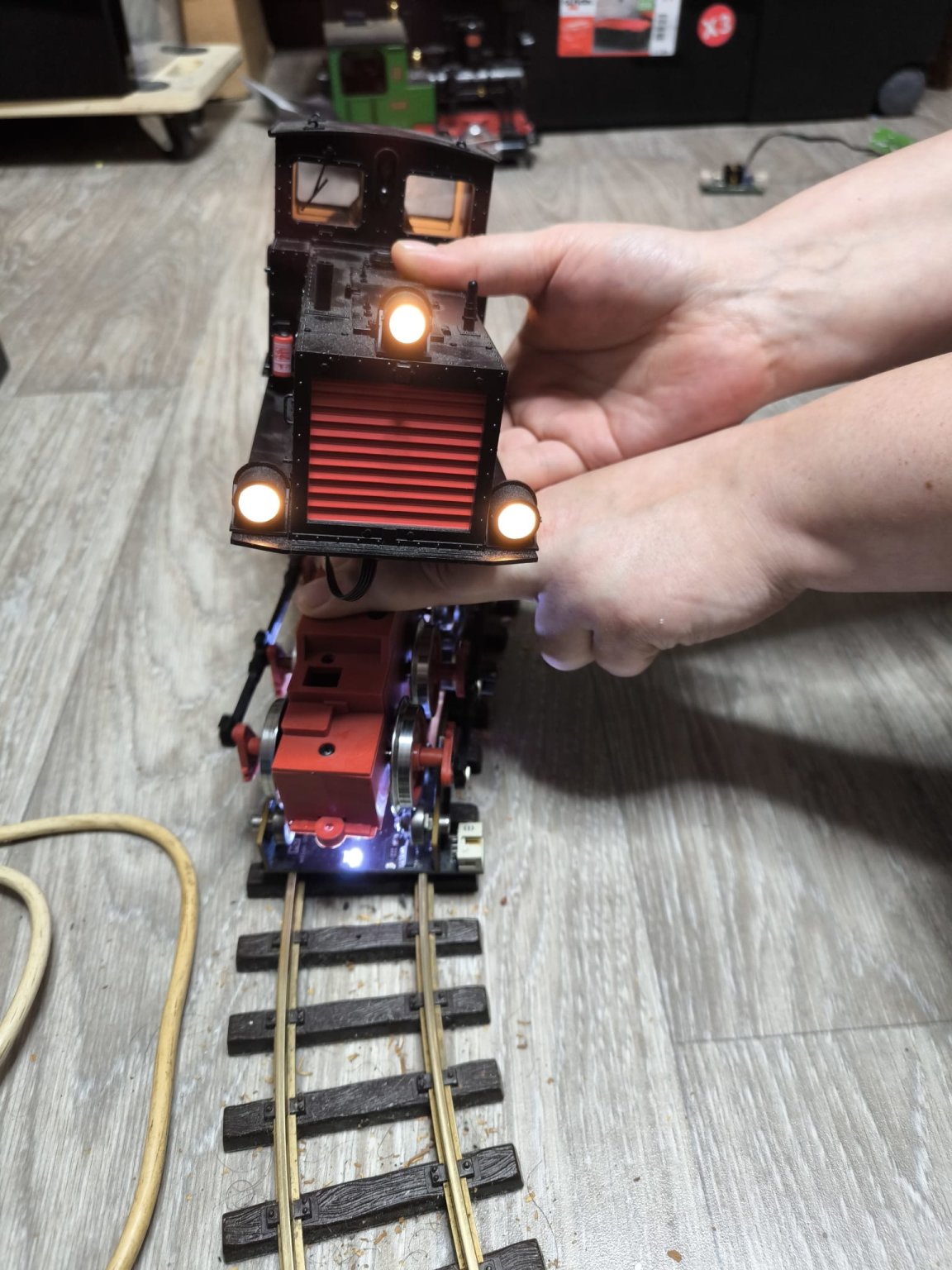

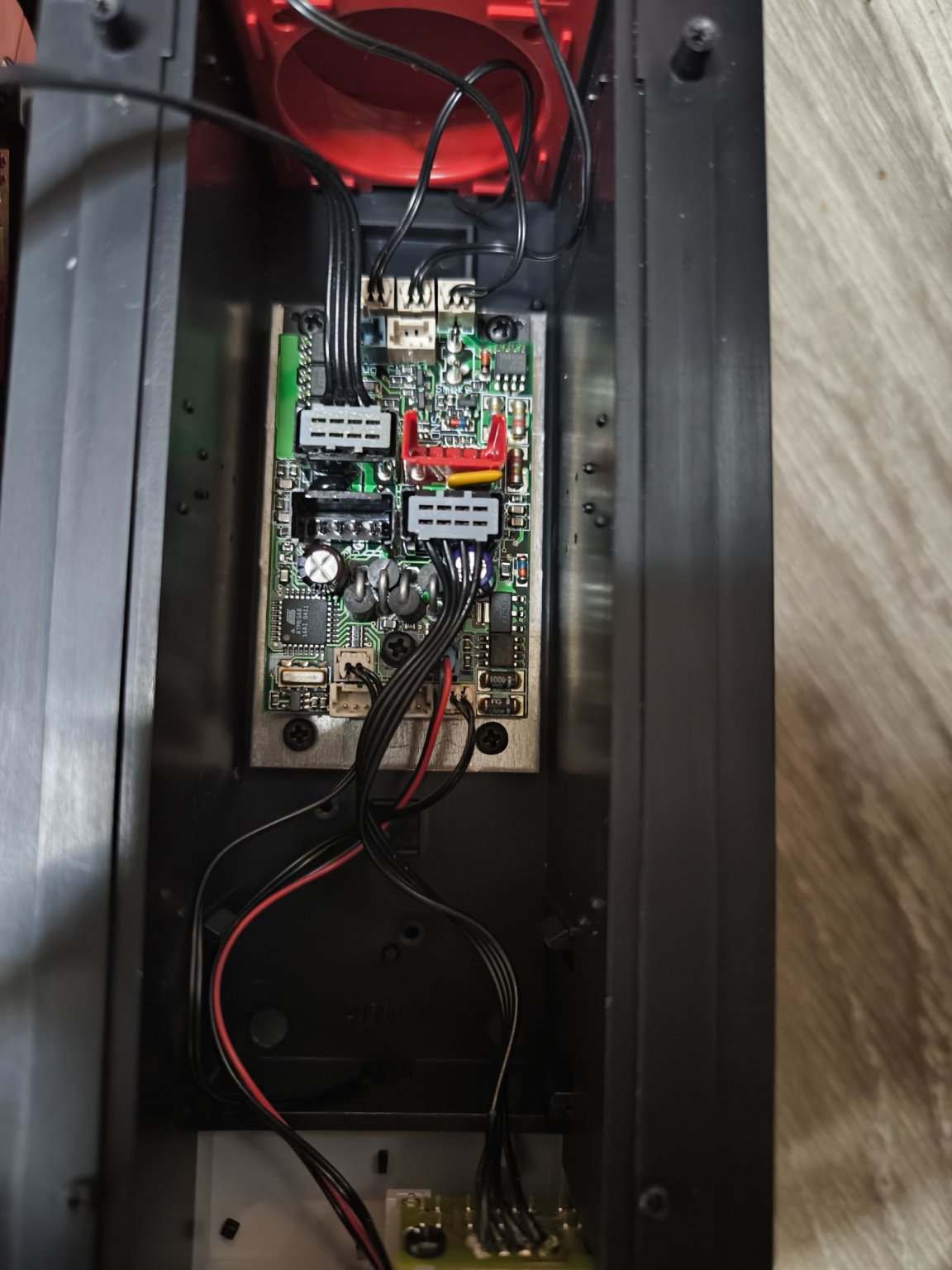

Hello everyone from France,
I have an LGB 20590 Kof engine. The lighting works in analog mode but not in digital mode.
I tried with another board and got the same result. I've never encountered this problem before. Do you know what might be causing it?

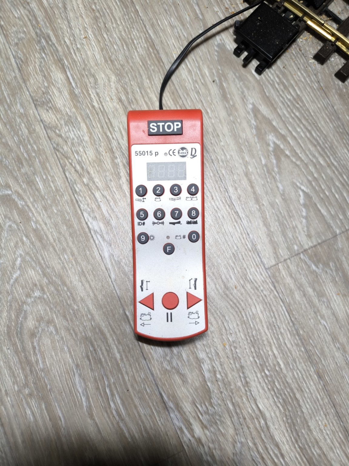

Erm sorty if this sounds a bit condescending but have you turned them on? Button on your handset will have a mini sun, generally 9.

If your speed steps are out of sync say 28 on the conroller and 14 on the loco chip, it can play havoc with the lights.
Failing the previous post.

'9' or '0' possibly, to turn then on.
Depending on the system, they may be turned off (for DCC) within the CV settings?
Yes, as others have said, F9 on Massoth Navigator or the sun button on an MTS handset.
