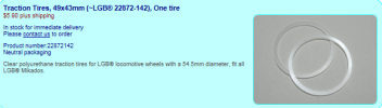

I've measured the Mikado wheels at 54.5 mm dia but not sure of the Piko BR 64 as cannot find any spec regarding wheel size. The LGB replacement part number 22872-142 for the Mikado states it is 54.5 mm dia. Just wondered if anyone knows the diameter of the Piko BR 64 wheel

Hello,
ok there are different drive wheels for Mikados.
I´ll ask my friends at the Spassbahn forum but I guess the Piko wheels are 61 mm.
P.S. Info it´s 58 mm
Best regards
Soeren

Thanks for the info regarding the Piko wheels, it appears the tyres would be a loose fit on the Mikado wheel.

Did LGB make 3 different Mikados?
58 mm, 54.5 mm, and 46mm?????
Greg
Hi Greg, didn't realise there may be different models/sizes so have just checked the wheels with a vernier, the smaller dia inside the grooved section that retains the traction tyre is 54.5 mm and a max of 61 mm dia across the non drive wheels where they contact the rail. The model is a 2004 build from the date label underneath and was purchased recently as 'new condition'. Appears to be unused but the tyres have deteriorated in storage.
Regards
Colin

Just received a set of Piko 38042 tyres from Pamak Hobbies in NSW who have been very helpful. They are smaller than the original tyre but fitted to the Mikado rim with a bit of stretching and appears to run ok and may be a feasible alternative to the LGB tyres, only limited testing at this stage as my layout requires a bit of maintenance due to the recent wet weather. Have just picked up a tonne of dolomite in my trailer from our local quarry, just waiting for it to dry up a bit.

Stretched tyres will be slimmer and will form a ridge between the rubber and the metal. Don't moan when you get unexpected derailments because we will have forgotten. How do I know?
