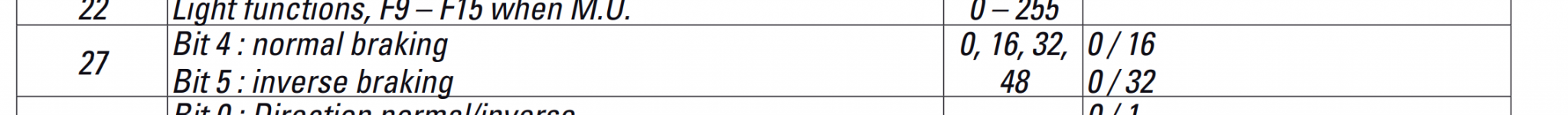

- ABC (Automatic Brake Control)
- Use diodes so that the track voltage becomes asymmetrical between phases
- Invented by Lenz
- Variation: "stop" and "slow" modes. In "slow", only every second pulse is asymmetric.

Zimo and ESU decoders claim to implement both ABC (including slow) and HLU. I've been thinking about adding some ABC sections to my layout, but was wondering what would happen if I then added a stock new LGB loco. It looks to me like it will just ignore the ABC signal.
