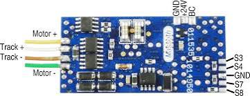

Hi,
Quick question, wheres the best place to connect a LGB 5v smoke unit on a massoth LS board?
Thanks
Sam
I would connect to the 'S7' pad, and use F7 (old school) to switch it..
Remember to set the CV for the voltage divider.
Other side of the smoke unit wired to Dec. + +24V pad.
