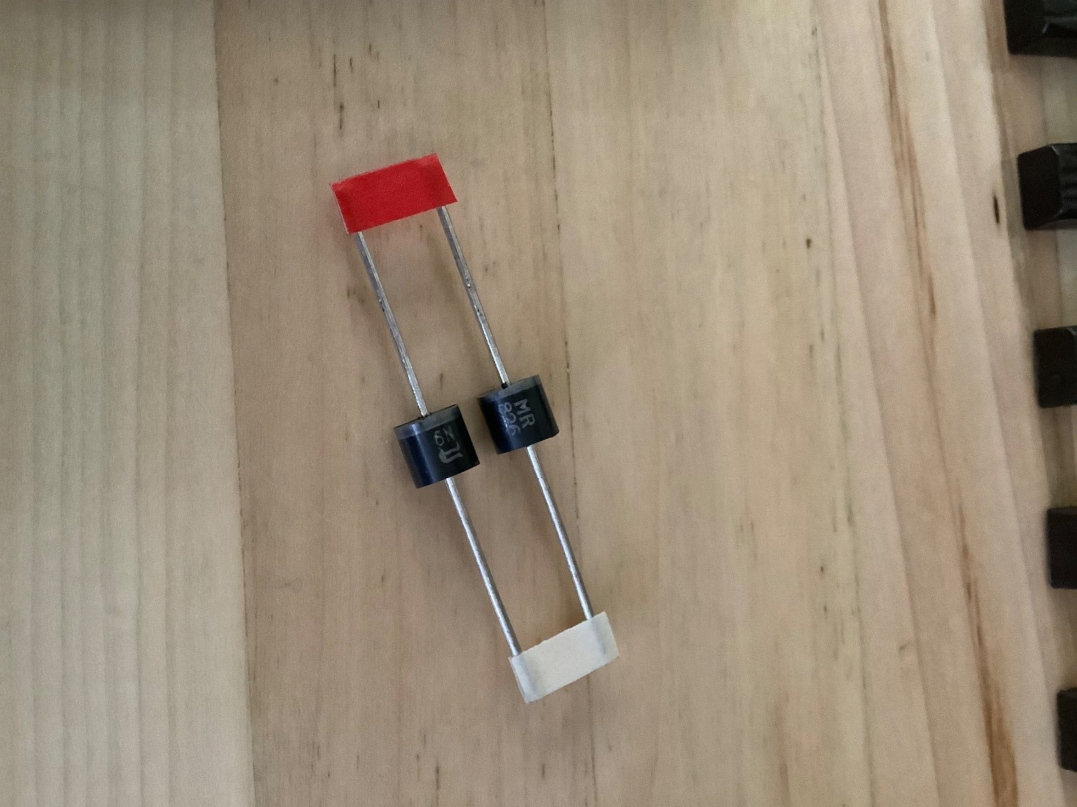

Hello everybody I have some issues with LGB 51950 and 51750
Could anybody help me telling me How to connect them?
The rail traffic light magneticnswrich works but No lights on it
I cannot find Any description on How to connect this two switches ( took a photo of them)
I am using playmobil 4375 as a transformator I think it should work properly with both items
Many thanks for your help

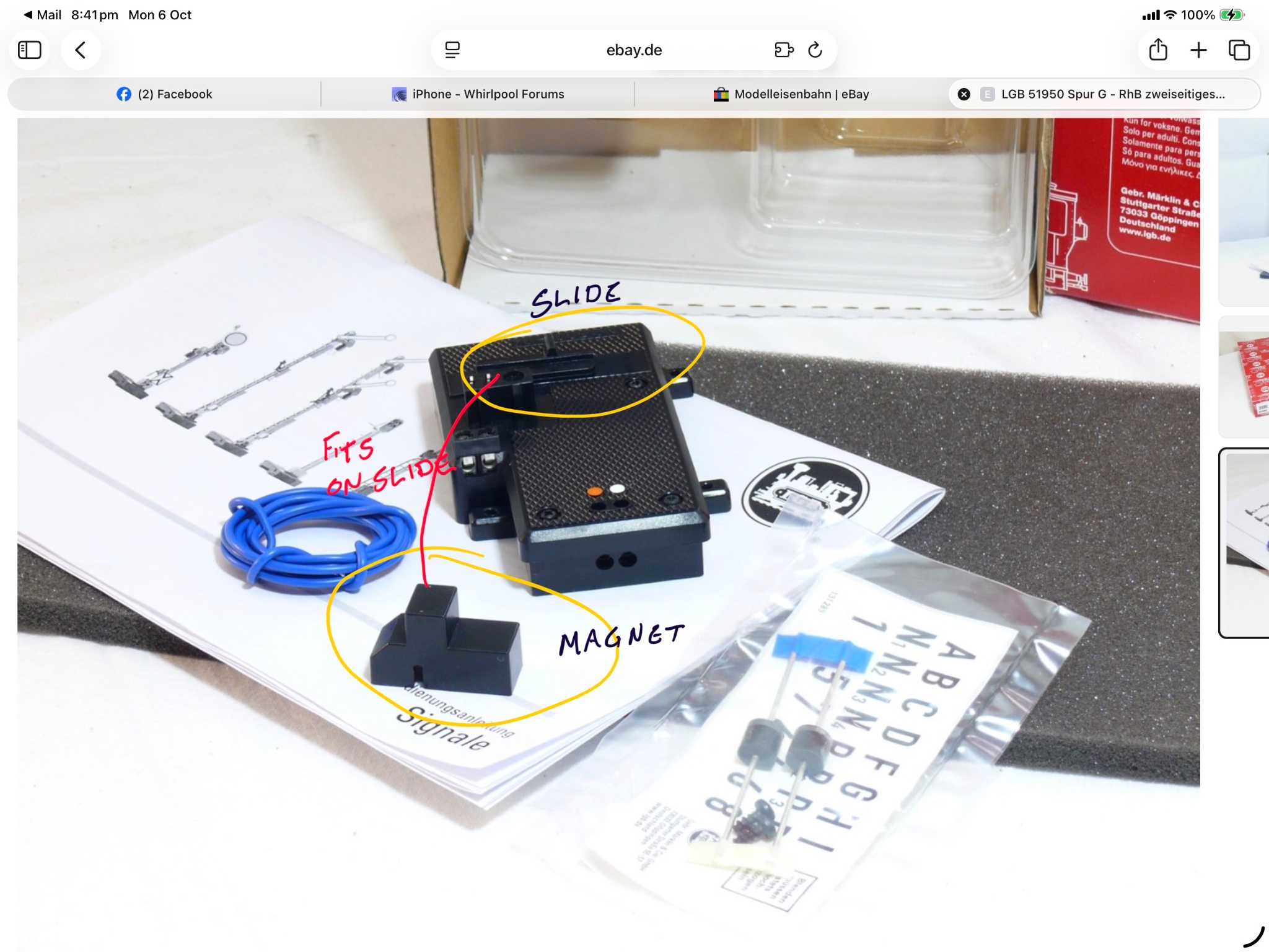

I believe you have to connect a separate supply for the lamp to light up. There is a terminal block for the 2 wires on the base.
I think from what you have written in your very good English, that you have the magnetic part working, which moves a red and green filter in front of the lamp.
In some respects, the colour light signal works in the same way as the semaphore, using a mechanical-magnetic action to move the filter instead of a semaphore arm....

The magnetic switch works properly moves up and down my issue is that both green light and red lights are not working….
Sorry for my not explaining properly in english the issue I am trying my best
Those two little items enclosed in the photo where do I have to wire them?
Many thanks for any help again

If you read the link in my post #3, you will find the information as to where to fit the diodes.
You might not need them if you have the magnetic solenoid working as it seems you are using a DC power supply....
The LGB RhB colour light signal aspects are controlled by a reed switch in the base of the signal column. The EPL "motor" moves a magnet on the top of the "motor" assembly and the position of that magnet in respect of the reed switch which determines whether a red or green aspect is displayed.
