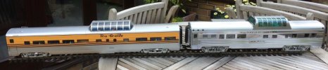

Picked this item up on Saturday from Top Slots and Trains, it arrived a month or so ago but I haven't had the chance to get upto Fleetwood. Anyway, tbis is the usual Marklin lgb standard that you expect apart from one, to my mind, major error that I'll come to shortly. The coach itself has existed in many guises over the years and it is big, I have put 10' curves in to accomodate the full train, the mouldings are superb, the paint work is crisp and the lettering/numbering is perfect. It is fitted with one axle of ball bearing pick ups on each bogie and the lighting is switchable and excellent and the car just rolls away on the slightest gradient. The only extra in the box is the usual extra hook and spring. This car is expensive so I am slightly peeved about the one fault I have found, the seats in the observation deck face the wrong way!! As you can see from the picks the plastic people would have to climb over the seat back at one end whereas there is a load of space at the other. I have compared this with pics of earlier releases amd the seats in tbose are the reverse of this one. I have e-mailed Marklin lgb about this and if you know anyone who has this car ask them to check, it may only be a batch problem rather than across the full production. A quick edit on this one, looking at the seat fixings the seats not only need reversing but transferring to the opposite sides, but looking again the car wou!d still not match the lgb pic on the box end where the seats face the long end of the car whereas with my fix they would face the short end. Perhaps move the seats then turn the full deck round.........!!!!!!

Pic from the box showing the correct seat spacing withe seat backs in the rectangular and square windows.

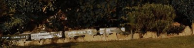

First the USA trains variety
The Aristocraft variety

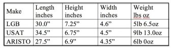

Here you go Mike:
Five pounds, six and three eigths ounces
Seven and a quarter inches from rail top to top of dome
Four and five eigths inches from handrail to handrail in width
Thirty one inches in length from coupling hook to coupling hook

So, with that info I have done a streamline dome car comparison of all three manufacturers, using length measurement from connecting corridor to corridor ends. (I have excluded the extra length for the couplers)
My Aristocraft cars are the most recent version (before Aristo's demise) and have the lowered bogies, interior detail, led lighting etc. BUT they are still a higher riding bogie than the USAT version and it appears that the LGB version has a 'shallower' bogie and is also 'lower' slung.
The USAT one is more or less spot on scale wise (1:29) but is almost twice as heavy as the LGB version
The Aristo one is a quite a bit short but is between the LGB and USAT for height but is much lighter even though it is also all aluminium in construction.
The LGB one is a bit short but is near the other dimensions of the USAT one.... BUT is the lightest of the lot at only near 5.5lbs
The LGB one (using their own publicity shots) does not seem to have many door mouldings besides at one single end on the ordinary 'passenger car' and the 'observation' car. Perhaps you can confirm if this is or not the case Kim?
So whether to swap to the LGB variety from my USA Trains ones.... the LGB are lighter but not so detailed.... BUT a six car consist would be about 28 lbs lighter which on my maximum 1:10 (approx 10%) gradient, it would be a blessed relief for my F3 ABB lash up!...but the USAT loco units, that I use, are all twin motored whereas the LGB 'B' unit is not motorized ........ Mmmmm maybe a miniature dilema....
USAT and Aristocraft end to end:

Yampa Valley ragbag consist with a single PA1 up front for power: it sometimes had an even shorter train and without the business car at the rear.

Greg, I agree that the Aristo are way too short but in other aspects they are not too bad at all. Once they have had little details added like ventilation grills and lower grills, they begin to get a 'presence'. The shortened length is always going to be an issue, and as I said in a previous post in the thread, my 'bashed' dome/observation car looks all the better for now being over 30" long (it has since had rivet strips added to the roof of the 'rear' section and a central light 'pod' is in the making)
