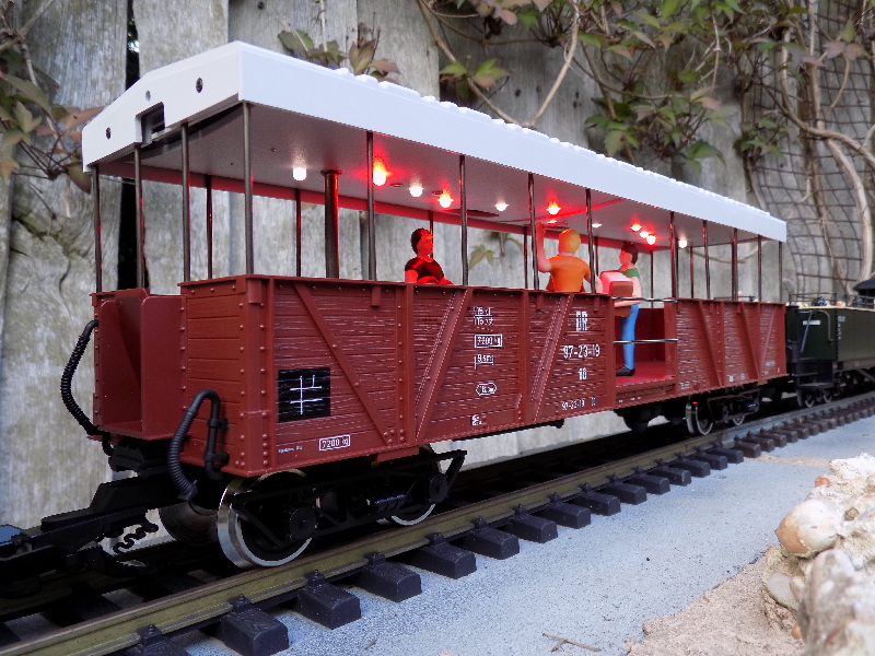

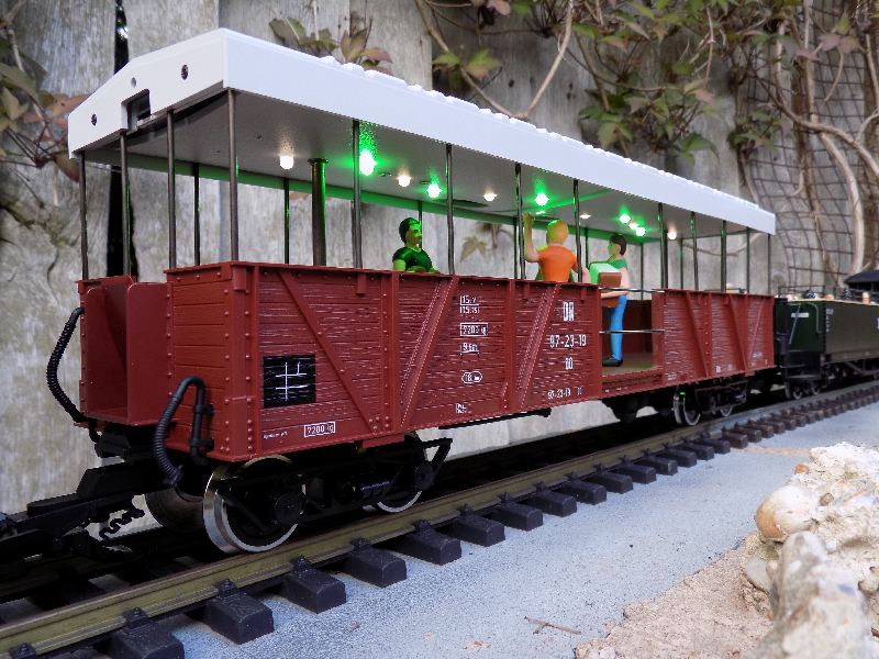

Folks, I recently came into possession of an LGB 33350 (new). Had it out yesterday and was working well so thought I'd take my hand at putting some custom music. Unfortunately, it's not working out.
The preloaded music is fine, however, if I try to add other songs using the converter - it doesn't work. The music file is converted and is visible on the SD card. The song will play on the computer. However, when attempting to play via the gondola, it will cycle through the existing songs but be silent on the custom ones. The coloured lights won't even flash.
These are my attempt so far:
I'm sure I'm overlooking something basic but wondering if anyone else had experience with this?
lgbmad and KentKeith - I believe you'd had one of these (or the 33353) in the past. Did you have any troubles with it?
- I've tried different sound files (both without DRM) both through the converter and manually changing to 16bit / 16khz mono WAV using VLC.
- I went to the LGB site and redownloaded the preinstalled files thinking there was a bug in shipped software.
- I also tried deleting an factory music file in case there was a max number of songs.
- I checked the new songs were smaller in file size (so wasn't somehow causing problems with a file being too large.
