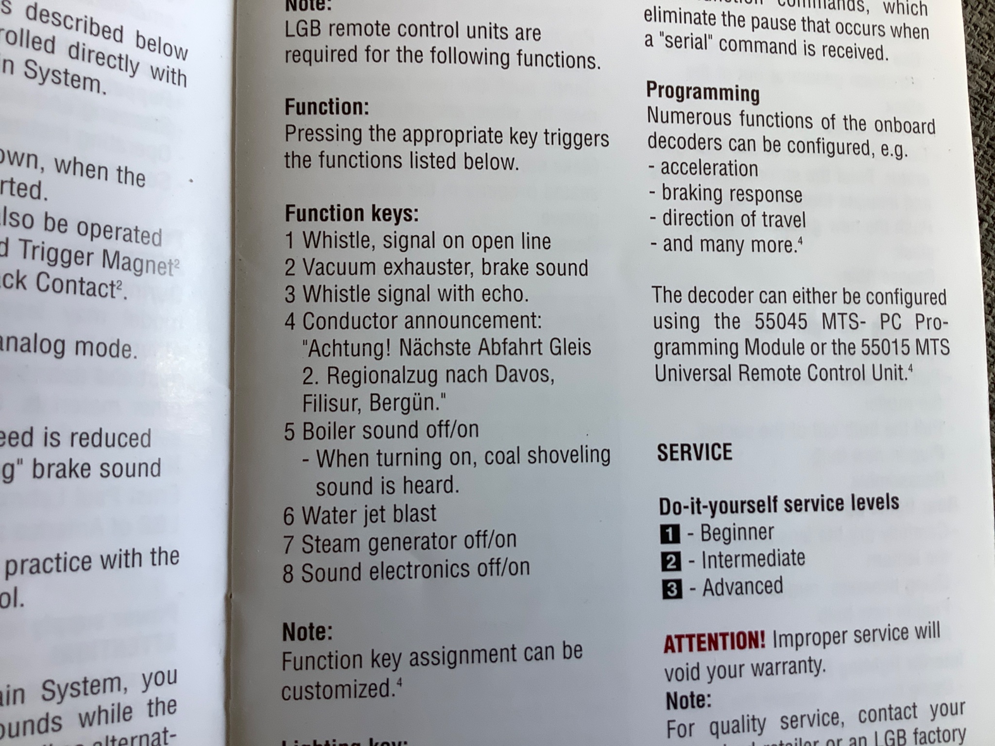

I recently purchased this lovely loco that I have been after for ages. Unfortuantly the loco came with no user manual which normally would be no problem as I could download it online. No matter how I try I cannot find a manual for the 20272 (sound loco). I would like to find the manual (or copy of) for details on the sound functions etc. If anyone could point me in the right direction that would be great thank you.

For sound decoders "bought loose" (for self installation) Massoth recently (20th November) announced that they had added a complete list of sounds and datasheets to their website (though the links to the PDF datasheets are causing them a problem, at present) at Soundprojekte für XLS, XLS-Onboard, XLS-M1, LS, S, S PluG – Massoth Elektronik GmbH but, once the datasheets are available again, the ones for a specific loco show (in two sections) the function buttons for the "standard" sounds, and those for the "Special functions". Here is what the one for "Heidi" shows . . .
However, a word of caution. I bought a "Heidi" with factory-fitted sound new in 2006 (my only LGB loco with factory-fitted sound) when I believe the digital chips were made by Massoth, and the allocation has significant differences . . .
F1 - Whistle, signal on open line
F2 - Vacuum exhauster, brake sound
F3 - Whistle signal with echo
F4 - Conductor announcement
F5 - Boiler sound off/on - when turning on, coal shovelling is heard
F6 - Water jet blast
F7 - Steam generator off/on
F8 - Sounds off/on
F9 - lights off/on
(before contradicting itself in a second list, in the "advanced users" section)
. . . but remember that whereas an LGB handset only allows 9 functions, a Massoth Navigator offers around double that.

After a bit of a search, I've found my copy! Won't be able to scan it until tomorrow, though.
I bought my 20272 new in 2006, well beyond "my price point" at the time, when there was no certainty that the bankrupt LGB would find a buyer. I think it was one of those models that, due to the bankruptcy, never got its user manual published as a PDF, hence your difficulty in finding it on line.

oh I have played with it Phil, and great sounds too .....but as a newby to DCC the CV values etc would be helpful as I would think they would be on the user guide.
Kev
Oh sorry just remembered I have one of these, been sat in a box for a long time. My user guide has the CV Values and the Function Keys, the Function Keys pressed on your handset are what calls the sounds. As you I think now have the manual you will see that CV131 to 192 can change the Function Outputs, but you mess with these at your peril. Some would say tis easy, I have been into DCC since around 2004 and would treat revising these with trepidation having tried and failed in the past! If you need more pages let me know and I can take pics for you.
Thank you dunnyrail and David........that is exactly what I have been looking for. All printed off and safely put with the loco.

Very welcome bit of a foul up with pic, 9 is for the lights On/Off.
