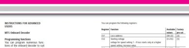

Check cv2, default 5 in the book, as that's the start speed. Other check is cv29 value if bit 5 is set to 16 there is a user set speed curve, you just want a value of 4 in there.
Might need to play with CV 2, which is usually called vMin or vStart. It should allow you to adjust the minimum starting voltage at which the loco moves.

Sorted now CV2 altered to 30, runs brilliant now.

CV2 often must be adjusted, it is affected by the actual track voltage, condition of the motor, etc. Nothing wrong with adjusting it, no harm will come.
