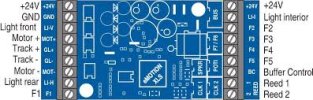

I'm currently installing a Massoth eMotion XLS in a Bachmann 3-truck Shay. But I have one question just to be sure. It is about the blue cable that i cut off from the 6-pin connector on the locomotives PCB-board. In the Bachmann documentation it has the name "B+ Common". Where am I supposed to connect that cable on the decoder, I guess "Dec +"?
