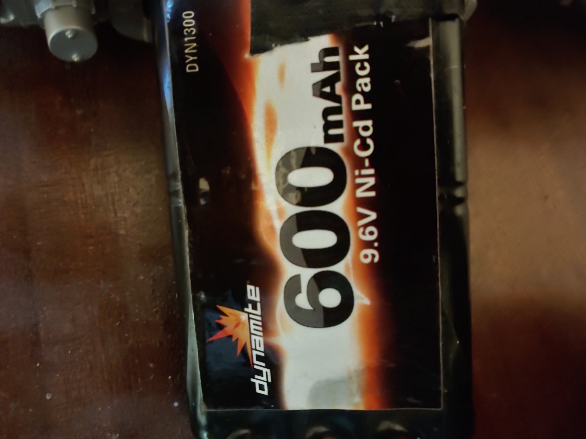

Doesn't have one but that is ok. So I got the fuse box and 10 v fuse. Should I connect to battery red wire or black? I can only assume that red is positive and black is negative. Having it rigged the way I have it the engine is going forward. Will solder it tomorrow is the plan .
10v fuse? Do you mean 10A?
Fuse to Red live run of wire.
Ya 10 A. So I assume I can use a 9 volt with that....well here we go. After this and a test run I can put the shell back on. Yaaaa
If your loco draws for example 2.5A then 3A fuse, this will mean it will blow sooner rather than later, you need to protect your battery, and if your battery is not designed to draw 10A then the battery could go into melt down before the fuse blows.
This is what I am using. I will keep the shell off a bit longer. Make sure nothing inside gets too hot.
