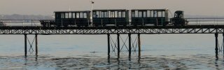

Well after finding out that Chris at Locoremote was creating a model of the "Gerald York", one of the 2 Brush locomotives that has been running up and down Hythe Pier for 100 years, I had to have one, so duly ordered the kit from him. He delivered it to me around 10 days ago when we met at the Pier. Unfortunately its SM32 so it wont run on my 45mm track and Chris is not going to create a 7/8ths version of this loco.
Image from Chris (lifted from hs website):
So now I have a loco (all be it not built yet), I need some carriages just like the real thing. The HPR usually runs 3 carriages and a flat truck and their stock consists of 2 x Passenger Coaches, 2 x Driving Coaches, 1 x Flatbed truck and 1x Fuel Bowser.
Due to neglect of previous operators, things are in need of restoration and with the creation of the Hythe Pier Heritige Association and the help from Hythe Shed (at the Pier) restoration of the train is taking place.
(Image HPHA)
At this point in time, the "Gerald York" tractor(loco) and and one of the Passenger Coaches have been restored. The other Passenger Coach is near completion and should be ready for the "Rock the Train 2022" celebrations on July 23rd.
Now what is the use of a model locomotive/tractor without any rolling stock.... so I plan to build all of the stock they use. Hopefully this thread will document my progress.
