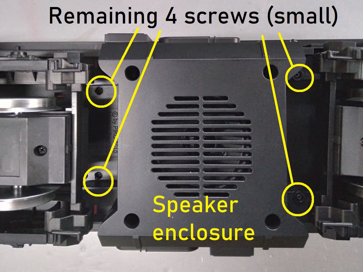

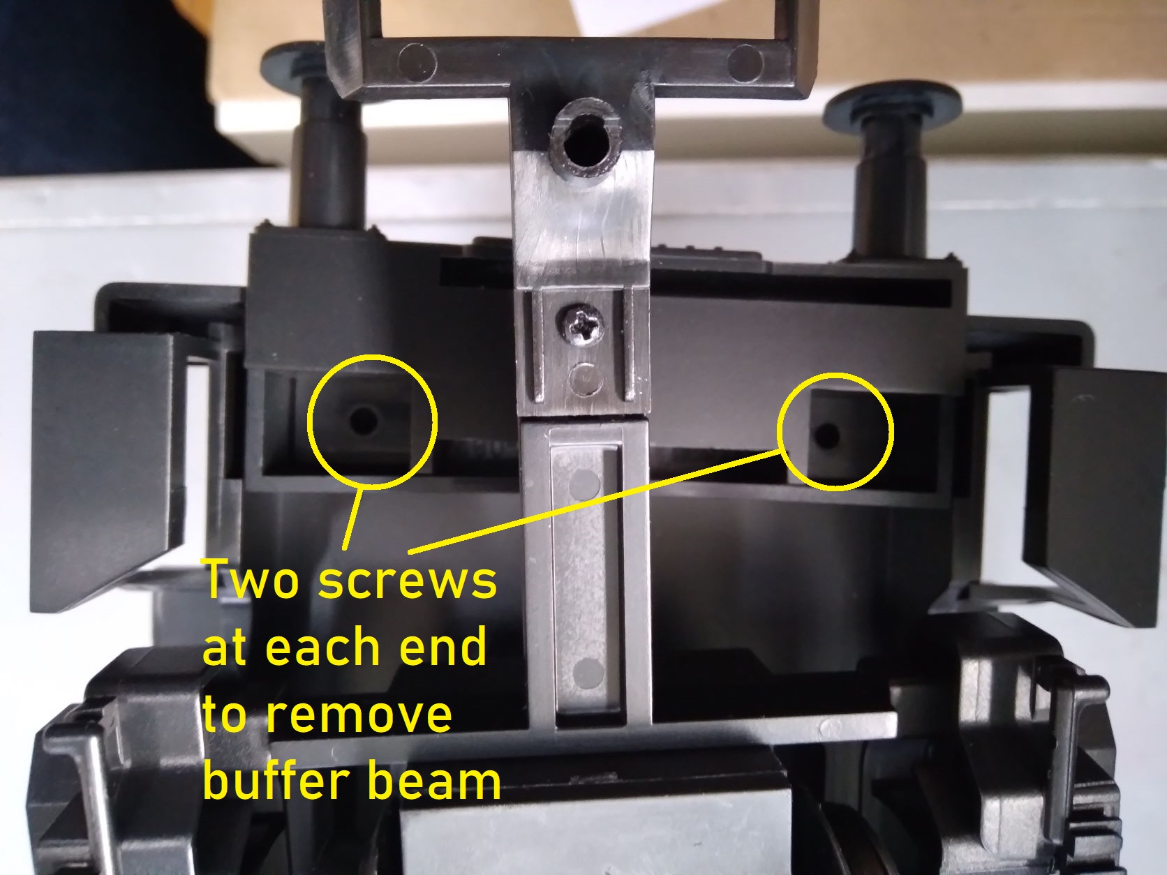

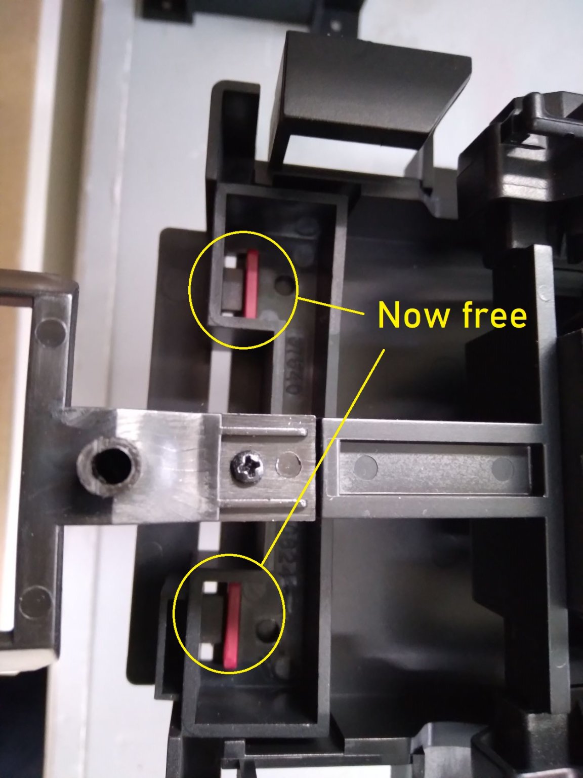

To open up the loco (i.e. remove the body shell), there are eight screws, four of which hold on the buffer beams which you then have to unclip as they have a slot and lug holding the body shell in place at the ends. These are larger screws, the other four are quite small and hard to locate, you have to swivel the bogies to access them. I think once these small screws are undone you could possibly leave them out as no way will the body separate once the buffer beams are locked in.

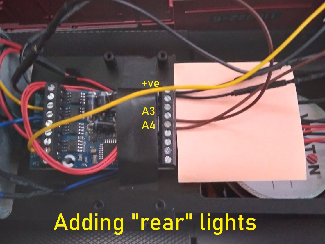

That's the existing wires covered, now to add the "additional lighting" LEDs from accessory pack 36016. They are wired in pairs for front and back, with brown wires (-ve) and (more) black wires (+ve). The LED lights plug into the holes in the light harness at each end of the loco. There is a handy "two into one" short piece of cable that allows you to plug in the two +ve black wires into one, which makes it much easier to connect to the decoder.
You could plug these into the LI-V (front) and LI-H (rear) light connections on the XL, in reverse of the white directional lights, but that would mean the rear lights would always be on. This would not be prototypical as rear lights are only on if the loco is running as a light engine, or at the rear of a train. To make them selectable, I used the A3 and A4 outputs of the decoder. Here are the connections for the XL (left hand side):
+22 - +ve common (black)
LI-I - unused
A2 - unused
A3 - front lights (brown)
A4 - rear lights (brown)
A5 - unused
A6 - unused
K1 - unused
K2 - unused
(The pink slip of paper is just there to make it easier to photograph the relevant cables.)

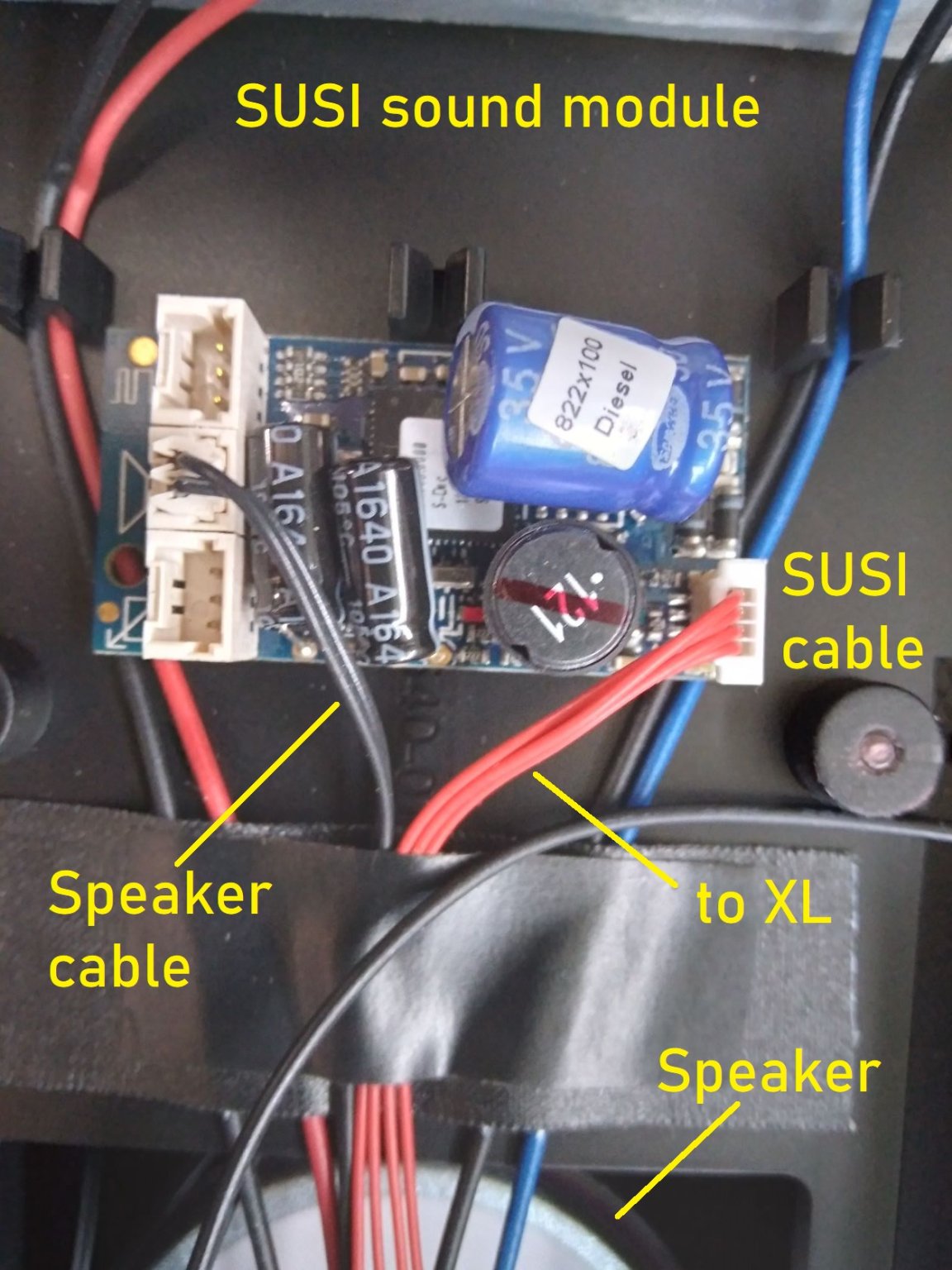

The only remaining cabling is for the Massoth S sound module (or any SUSI sound module). You can connect these directly to track power but generally I prefer to use the SUSI connection. If you are going to use SUSI you can remove the white and brown track power cables from the Massoth S, or just wrap them out of the way. Plug the 4-wire cable into the SUSI socket of the XL and the other end into the SUSI socket of the S, plug the loudspeaker cable into the S and job done. The space for the loudspeaker (70 mm 8 ohm 2 W) is in the chassis well.
