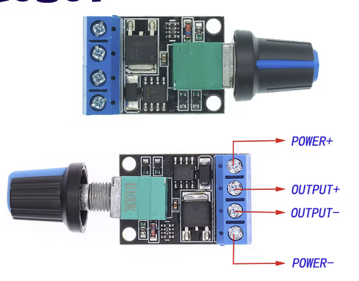

Not sure but a DC - DC voltage buck ? Would put a top stop on the voltage a motor can receive and cap the loco's top speed. And they are easy to adjust so you get a desired voltage regulated speed cap. It would not slow how fast it got there though.
LGB used something on their track cleaning loco to slow it independent of the track power, used to rotate the cleaning heads at speed. I have seen some simple and cheap manual speed controllers that might do the job if interposed between motor and power supply. Something like this ESC-180 Max
EDIT - From what has been said by PhilliP neither of these are options as they cannot deal with polarity reversals. Oh well, back to the drawing board.

All the speed controllers are going to be polarity sensitive, so fine if going forwards. - Many would release the magic-smoke if the controller was changed to reverse!

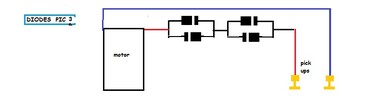

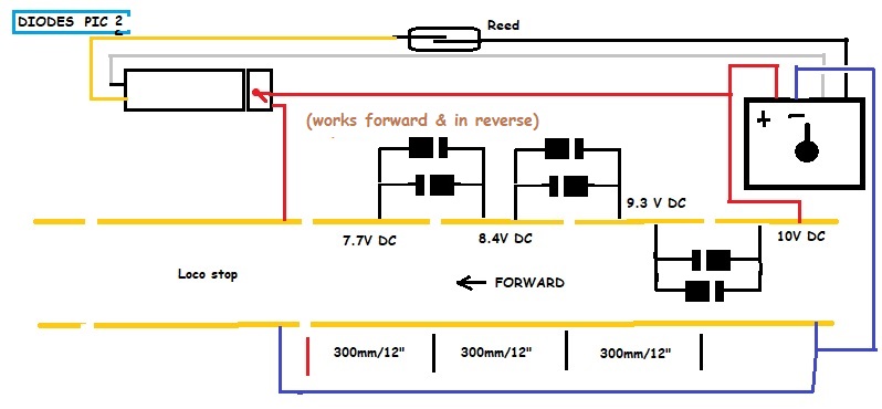

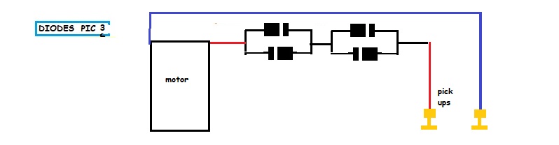

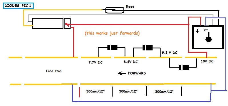

The diode string works in both directions, is quite simple, but you will need to set the speed control to the same setting each time. - There will not be a constant relationship in speed between different settings of the controller between the different models.

Do you have a meter, so you can measure the voltage on the track?
Set a loco running, at the speed you want it. Then measure the voltage on the track.
Do this for all your loco's. You will then have an idea of how much you need to reduce the voltage by, in the loco's that are too fast.
Each diode in the 'string' will reduce the voltage by about 0.6V. So you can get the 'string' about right to start with.
Until you know the sort of voltage you need to reduce by, you can't decide if this is a viable solution for you.
Use the series diode method..... if you need more detail on what to do, you will need to figure out what voltage you need on the track to get the speed of movement you want from each of the too fast locos, then report back here.
