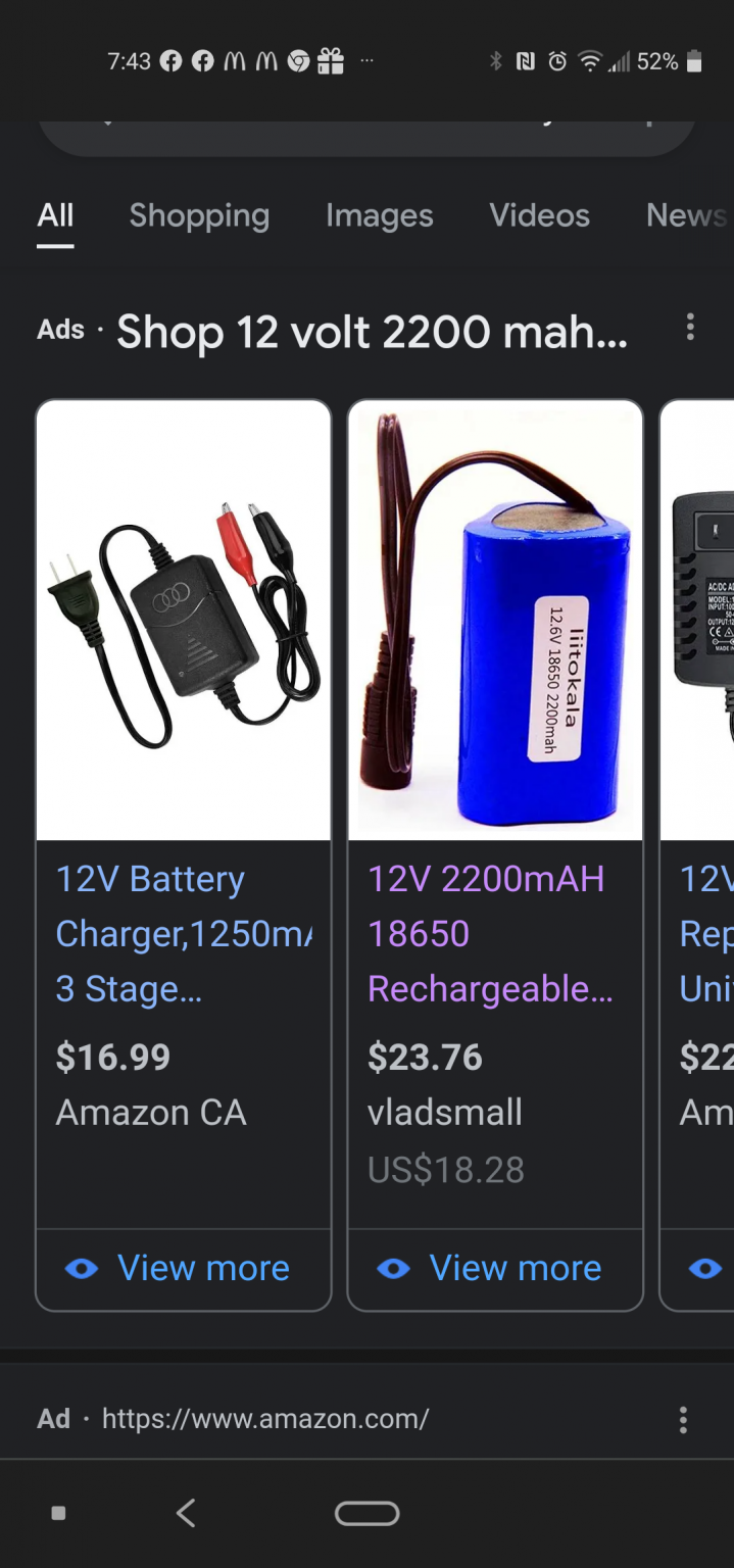

See how the 9 volt goes tomorrow after a 6 hour charge. If not which is what will probably happen I might order this.

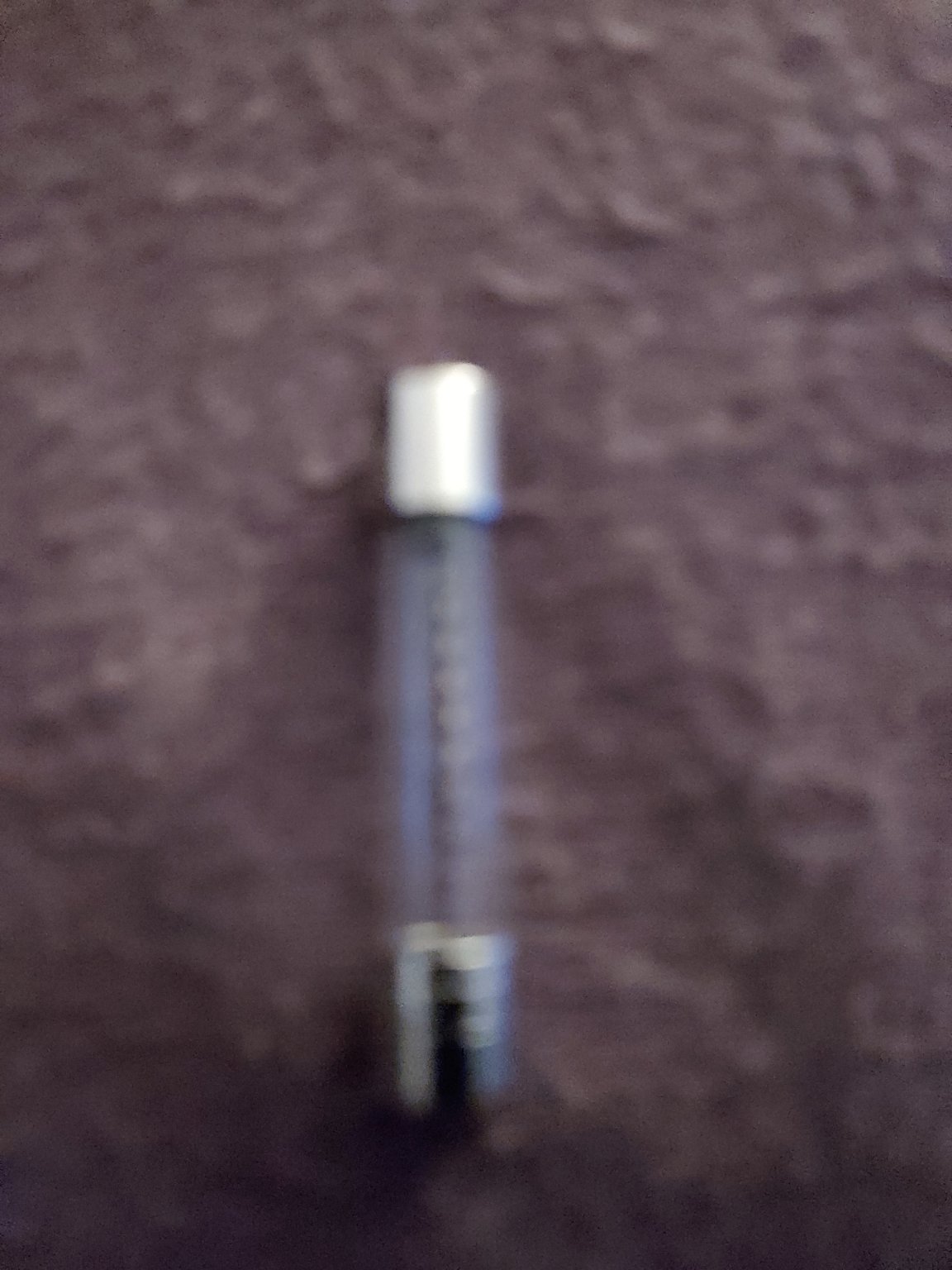

Yes thanks for your help Greg. I am totally frustrated. I got other bad news today as well so got to relax a bit. I missed an important e mail and is too late to do something about it. Both fuses look fine. This is the 2.5 a that I am using

OK, looks like a slo-blow, which might not be a good choice. Do you have a small meter that you can test these with? Harbor Freight makes an inexpensive one.
The reason I am mentioning it is that I have been fooled before, the fuse extends out of sight where the metal caps are. Some times the fuse breaks there: it can look good but be "open".

I will try it with the 9 volt tomorrow. If not a go I will get more fuses and new fuse holder.
Ok I might have something hanging around. There is no Harbour freight in Sarnia. As I said if I go get some fuses I will get another fuse carrier. ...so the 12 v and charger I put a picture up of. Will that work?. At this point no more 22 v. I do not want to further destroy my train.

Ya thanks Greg. I found out why it was not working properly. A female connection didn't quite catch the wire. So I got my 9 volt hooked up. After a 6 hour charge it only ran around 2000 feet. The battery is around 12 years old and has been through a lot recently. 20 times around pulling 3 rolling stock I can get my addiction fix. Don't smoke drink drugs or wife...eeek ha ha so can't complain. I really prefer being able to have the battery in the engine like what I can do with the 9 volt. So Greg can you look at the pictures of the battery and charger I put up and tell me what you think. Do you think the 2 are comparable? And do you think they would work in my engine? Much appreciated and thanks Greg.
