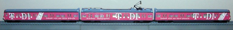

Not that it really helps the discussion with regards to current technologies, but I still carefully maintain my old Alps Microdry technology printer (Actually a Citizen re-badge of an Alps) and a copy of Wndows ME as it has the best drivers for the printer. I can print colours, metallics and white on decent thin waterslide decal paper. I find it much better than inkjet decal papers and printing techniques. The Alps printers are long out of production, supplies of the cartridges are getting hard to find now, but I shall keep it going as long as I can!
All the white decals on this N scale model were created and printed using the above system back in 2005.
