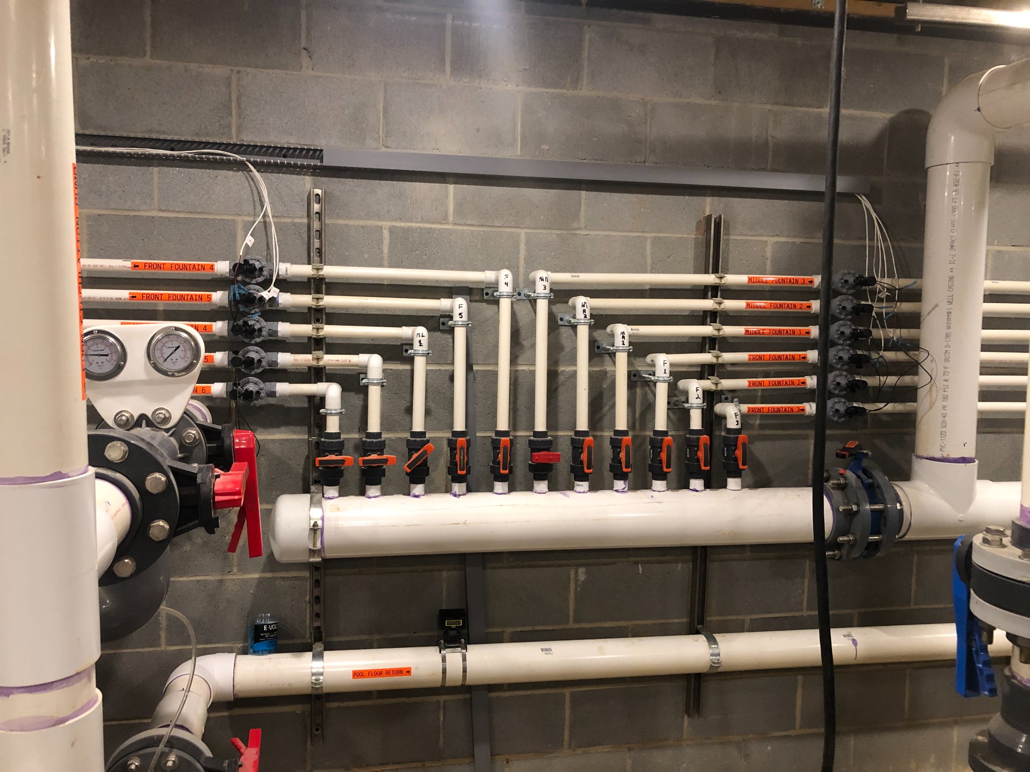

I don't know that I would even do this, I'm just brainstorming. However, my personality type will do things just because people say I can't. I once built a splash pad/pool on a unrealistic budget to prove all the big pool companies wrong. Hell, a large splash pad company dared me to reverse engineer their stuff and build it for less then they said they could. Later that evening I found all their suppliers on Alibaba and had a preliminary drawing of a working fountain canister complete with the schematic for a control system using common irrigation parts. Here's a pic of of the production iteration of the control valve manifold. All of it custom fabricated. So, yeah I tend to get things done when I want to.
