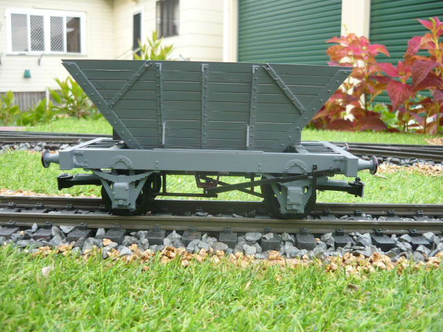

This and its relatives were assembled this way, if you look real hard you can see some white in the corner of the chassis beams on the left.
I have good success with Wellbond as well and it is fast becoming my go to adhesive for just about everything (Discovered it after building these).

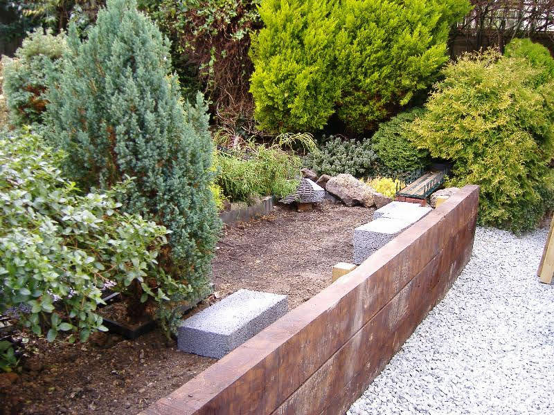

Well, as thread drift mode is now engaged. In amongst the hard-core debris removed from behind my house, when removing the concrete capping off paths and a patio, there was reported to be some asbestos. The contractor used, our local general works builder, mentioned it after doing the job as an aside. No extra cost, no questions. This area had always been a bit of an issue cosmeticaly and because of drainage issues it caused. When dug out and levelled it created a nice sunken area, in front of the garden, handy for working on the railway. See pictures.
What had been used to provide the hardcore used to build up the area previously, capped and sealed ? Apparently an old outhouse, broken up whole in-situ. My house is old, as in 300 years, property. The asbestos, probably its roof. The contractors ? They just happen to be neighbours and have been in business for years. Schtum ! Max
You can get some idea how much had been dug out. Those capped paths had reached, mostly, the height near where the tops of those "sleepers" are. A real issue at the back of the house as it caused water to be retained and seep into the walls.
