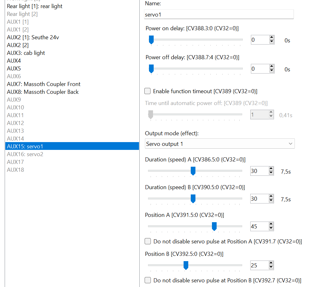

I just bought the MDS Modell uncoupler and servo (type = GH-S37D) and try how to connect it to an ESU Loksound 5XL.
The connection is via the three-pin connector (AUX15) and I have set the function output to "Servo 1". I left the default values for what they are.
Next, I linked the AUX15 output to F25. However, now if I press F25, keep pressing or release, the servo doesn't move at all. Any idea what I should check or reconfigure?
thank you, Bruno
