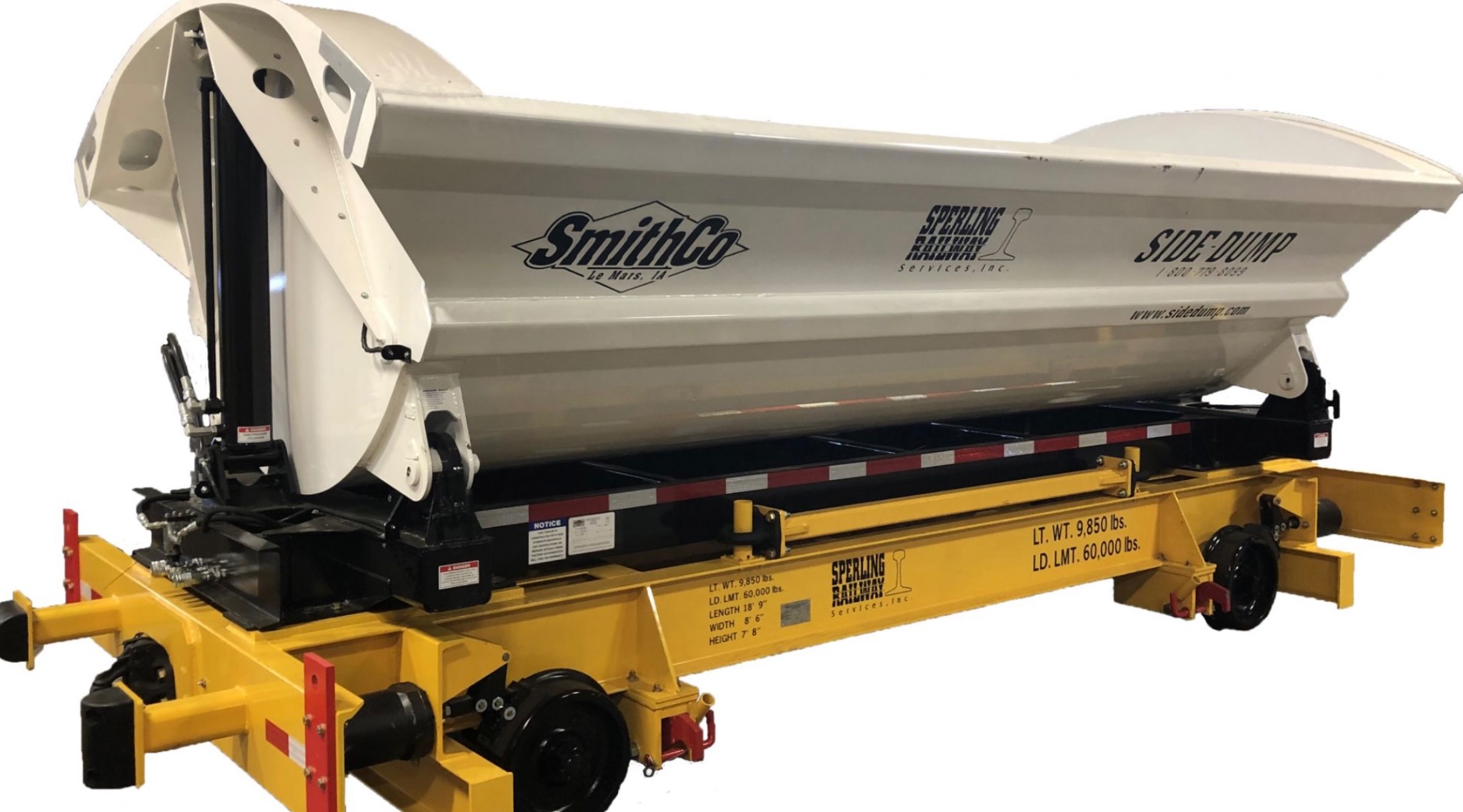

Sorry - I feel that I must be a little pedantic, this is actually a Hopper Wagon where loads are dropped out of a stable wagon with chutes either below or to the sides. Dump trucks generally tip the body to the side as in the example.IMG_8702.jpeg
Though many get the Railway terminology out of kilter, particularly since privatisation where much knowledge has been lost.
