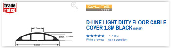

I'm wondering if you could do something with a rubber strip designed to prevent cables being a trip hazard.
I'm aware that you are not in the UK but, over here, Screwfix are kind enough to provide dimensions of the version they sell . . .
You'd obviously need to cut it lengthways (and put each half on either side of the track, and maybe add something between the rails), and 12mm might be slightly less that the height of the top of your rail . . . but maybe other suppliers have a "heavy duty" version that is a little taller.
Hope this sparks some further thoughts.

Would this be feasible? Obviously you would need to pop out the cover each time the line was used, but it's construction suggests it would be hard wearing enough to take the weight of a vehicle crossing it. There's loads in use in our local supermarket car park.
That looks an ideal solution. Filled with gravel, it would form good drainage too.
