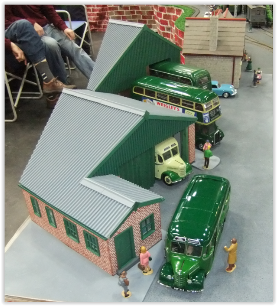

B&Q sell sheets of corrugated aluminium. Possibly slightly under scale corrugations but it has the advantage of being available in large sheets if you have a sizeable roof to do. I just drew/painted a representation of separate sheets on mine, which looks fine at normal viewing distance. 6f1e999c1b61463ebadd1c6f9252ceff.jpg

B&Q sell sheets of corrugated aluminium. Possibly slightly under scale corrugations but it has the advantage of being available in large sheets if you have a sizeable roof to do. I just drew/painted a representation of separate sheets on mine, which looks fine at normal viewing distance. View attachment 280671
Interesting but does not show up on the site search I just did?

Yes tricky on the iPad as well, a look see needed at the local BnQ.
