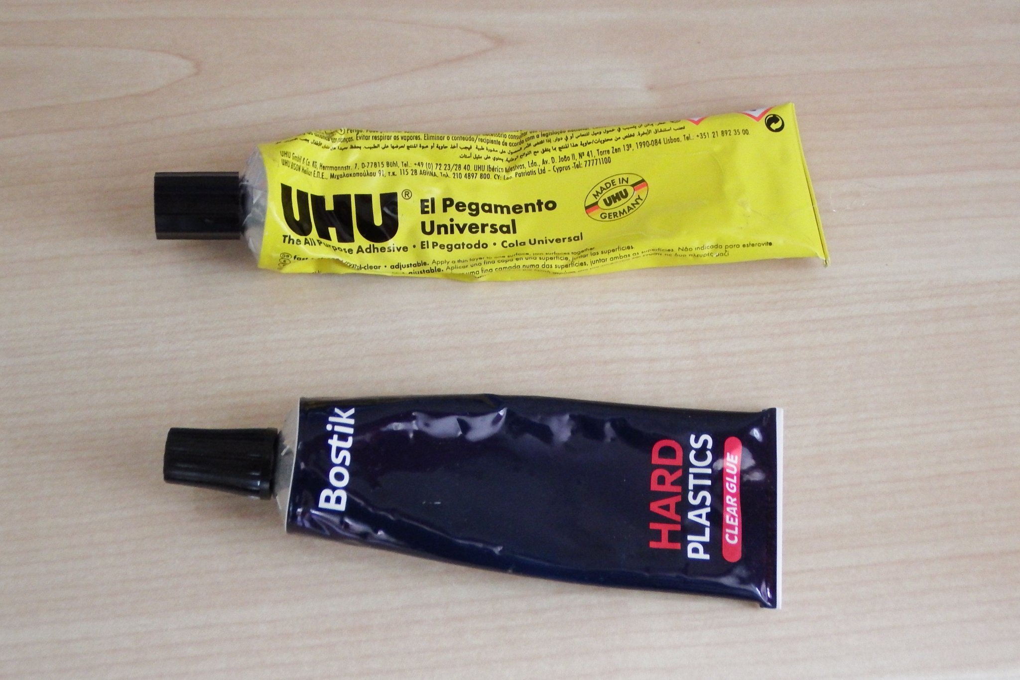

I'd forgotten I bought some UHU All Plastics after reading about it on a German Forum. Not actually tried it yet though. So my specialist glues pictured below.
Adhesive1 uhu.JPGAdhesive2 uhu.JPGAdhesive3 uhu.JPGAdhesive4 Lederer & 5 second fix.JPG

I've used Bostik hard plastics glue to glue older LGB plastics together successfully. I have always clamped the components and left them for about a quarter of an hour and I've not had any issues so far. Where I've needed additional strength I've added plasticard behind the join and glued with the same Bostik product.
It might be worth knowing that Luran and it's derivatives are just a brand name for someone's version of a polymer known as ASA (Acrylonitrile Styrene Acrylate). A quick bit of searching on what bonds ASA well brings up super glues and acrylic cement or even welding it using Acetone.
I don't own any modern LGB but it might be the case that because of Euro recycling laws the material type will be moulded on the part somewhere. Usually close to the manufacturer's name, part number and some other identifiers. It would usually be a 2 or 3 letter code like ASA, PP, PA, ABS or similar. If you can find that it might help guide you in the direction of what to search to find the best adhesives :)
